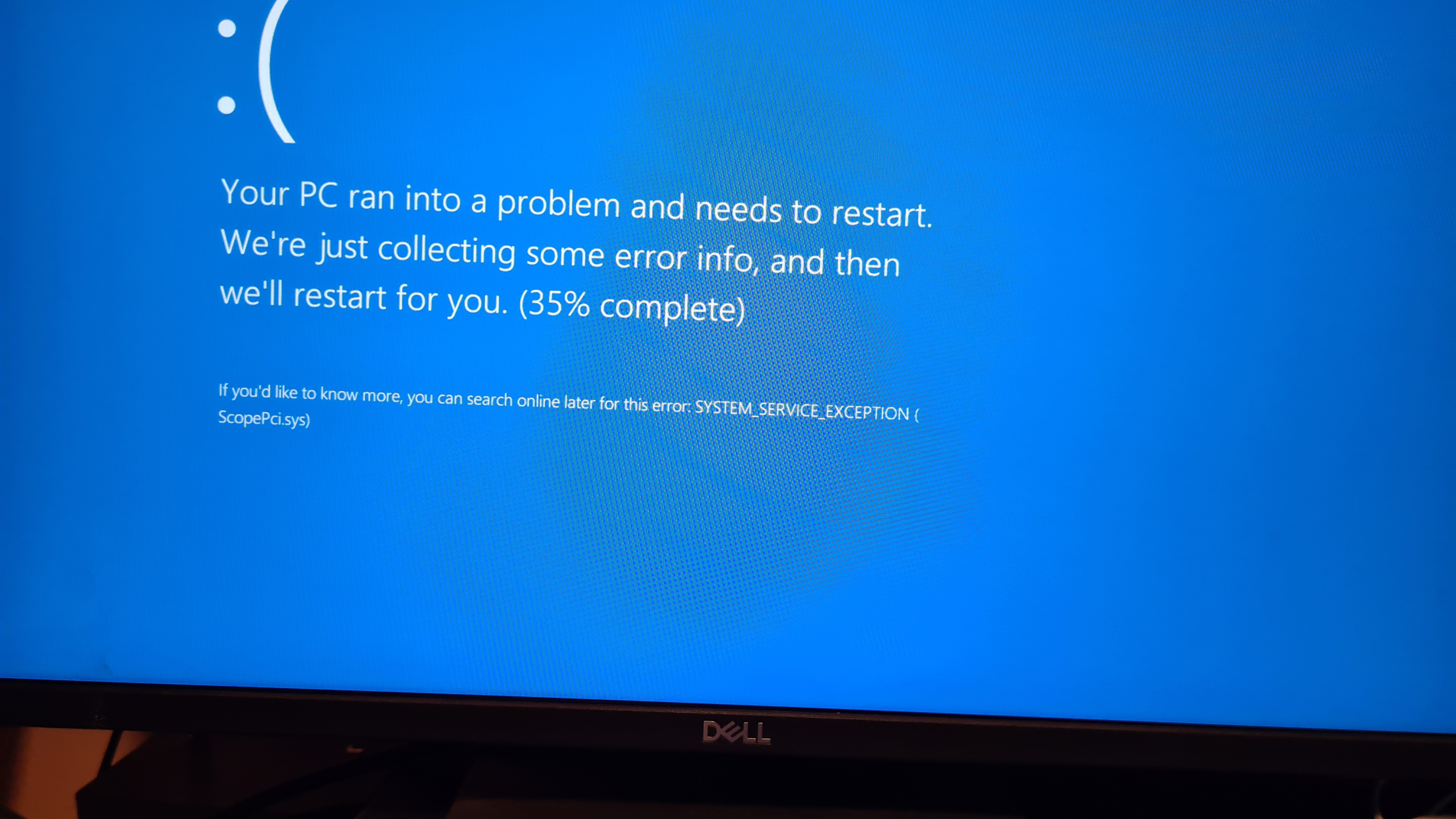

Hi
I have a long time stable working system with Win 7 (no internet) so I am doing some Win 10 experimenting on a separate SSD system disk.
System Specs: Windows 10 Pro 64-bit
MSI Gaming 3 computer/motherboard. Intel i7-4790K 4.00GHz
32GB Dual Channel DDR3 RAM
3 x Pulsar 2 cards, no IRQ conflicts.
Scope 7. Installed successfully.
SAWStudio recording/multitrack software (not common but brilliant programme).
32bit version: works perfectly using Scope Asio drivers.
64bit version (SAWStudio 64): Will load and run using standard multimedia drivers. Crashes to blue screen with Scope Asio drivers. Blue screen says Scope.sys is the problem.
Very strange. Have tried Win7 compatibility mode for both Scope7 and SAWStudio64. Run both as administrator.
Scope7/SAWStudio64 combination works perfectly with Win7. Why bother with Win10 I hear you say. Only because I cannot get an internet connection with Win7, wired ethernet or WiFi. Have tried most things I know with updating correct drivers etc. Both internet connections work with Win10.
Of course it is a mixed blessing having internet on an audio computer. But it is useful for updating VST programs etc. particularly the complex guitar and drum ones. Updating via another internet computer and transferring across is awkward.
I'm not expecting too much particularly as I use unusual recording software. But if anyone has any ideas I can try I'd be grateful.
Best Regards
Jonathan

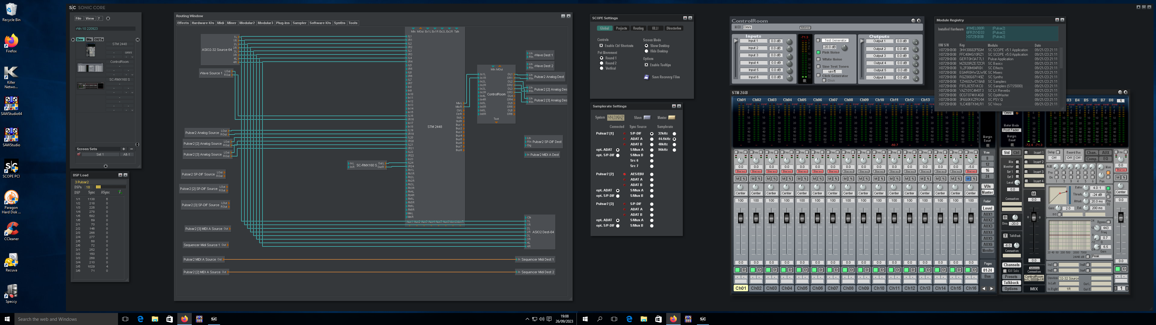

- Screenshot (1).png (578.13 KiB) Viewed 11953 times

- 20230926_181016.jpg (2.73 MiB) Viewed 11950 times

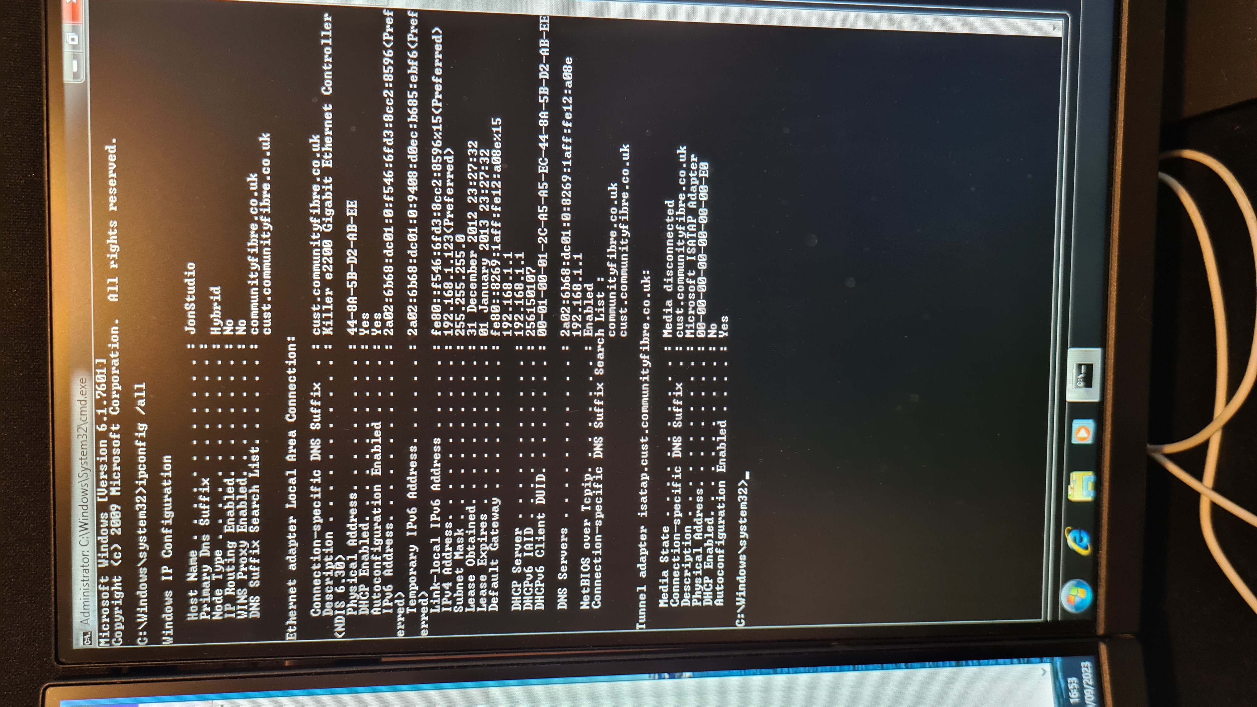

i'm not 100% sure how you are trying to connect to the internet.
Could you issue this command from cmd and paste the results?
ipconfig /all
Re: Win 10 Scope 7 crash with SAWStudio64 Asio
Posted: Fri Sep 29, 2023 8:00 am
by Jonathan T
- 20230929_165316.jpg (2.82 MiB) Viewed 11846 times
Hi djmicron
Confusing because I've tried both wired ethernet and wireless
This is the cmd prompt with only the ethernet adaptor enabled, no wi fi activated
The ethernet socket at the back of the computer shows solid green and flashing yellow

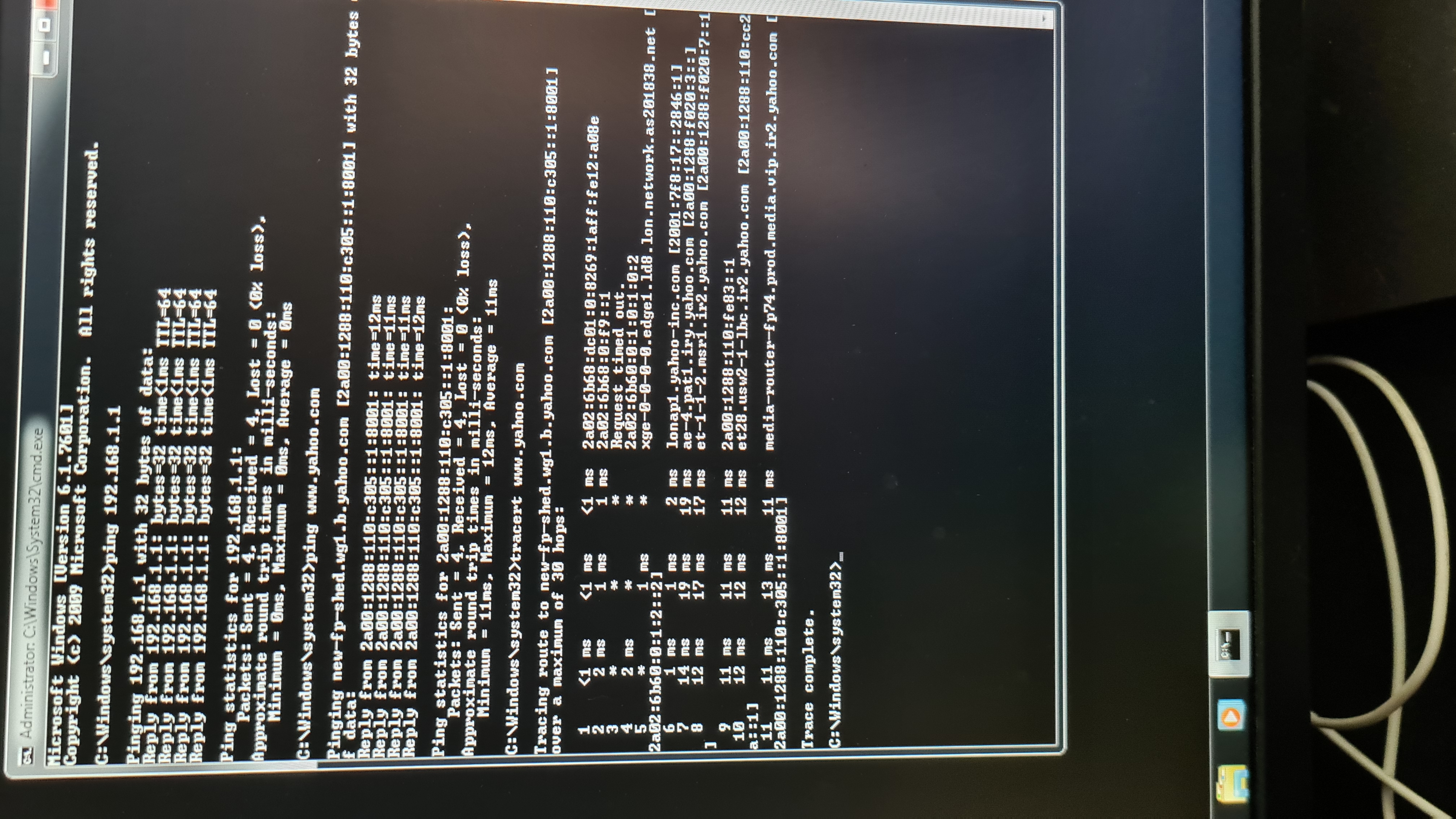

Posted: Fri Sep 29, 2023 5:18 pm
issue this command: ping 192.168.1.1
show response
www.yahoo.com
show response
issue this command: tracert
www.yahoo.com
show response
Posted: Sat Sep 30, 2023 6:48 am
by Jonathan T
- 20230930_153142.jpg (2.57 MiB) Viewed 11803 times
Took a while to complete the tracert response
