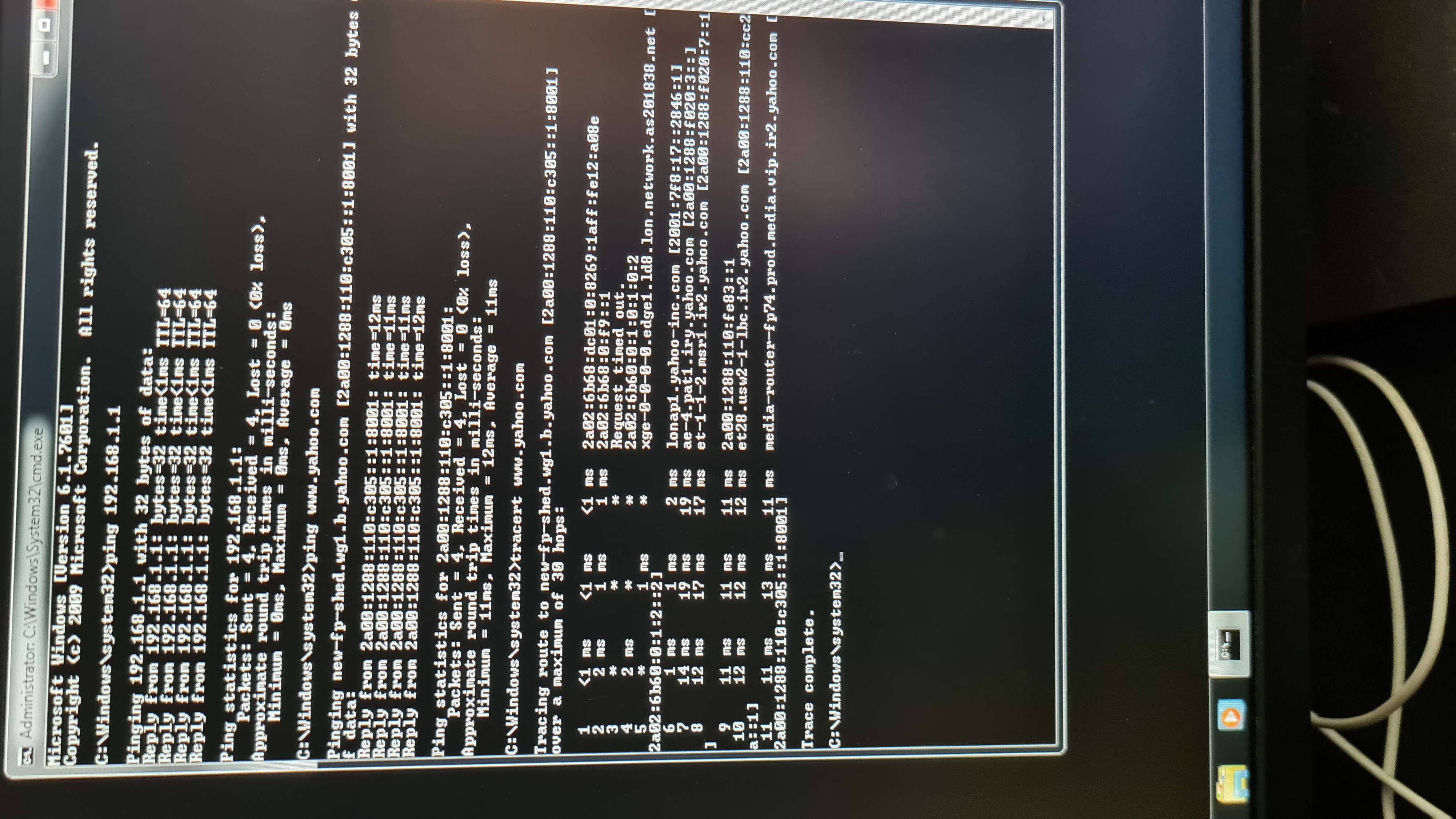

Re: Win 10 Scope 7 crash with SAWStudio64 Asio
issue this command: ping 192.168.1.1
show response
issue this command: ping www.yahoo.com
show response
issue this command: tracert www.yahoo.com
show response
show response
show response
show response
Took a while to complete the tracert response
