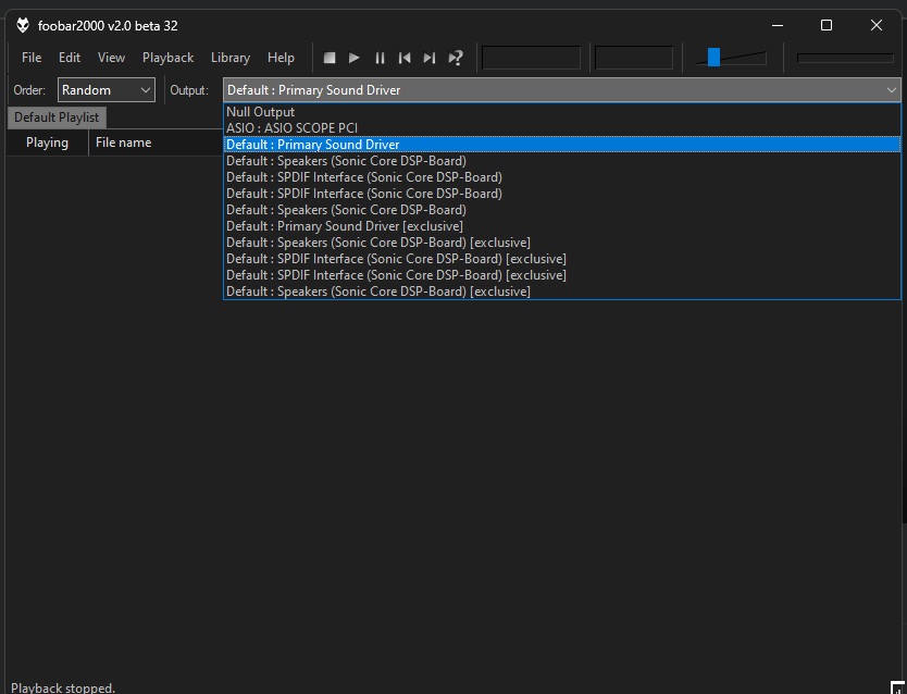

You could also use foobar2000 with the asio-plugin. This way you could check if feeding into scope works.
My driver in windows-device manager identifies as: date 30.11.2017 Version 7.0.4.0
(If you installed 5.1 parallel to 7.0, you need to force the right driver by installing manually.)
