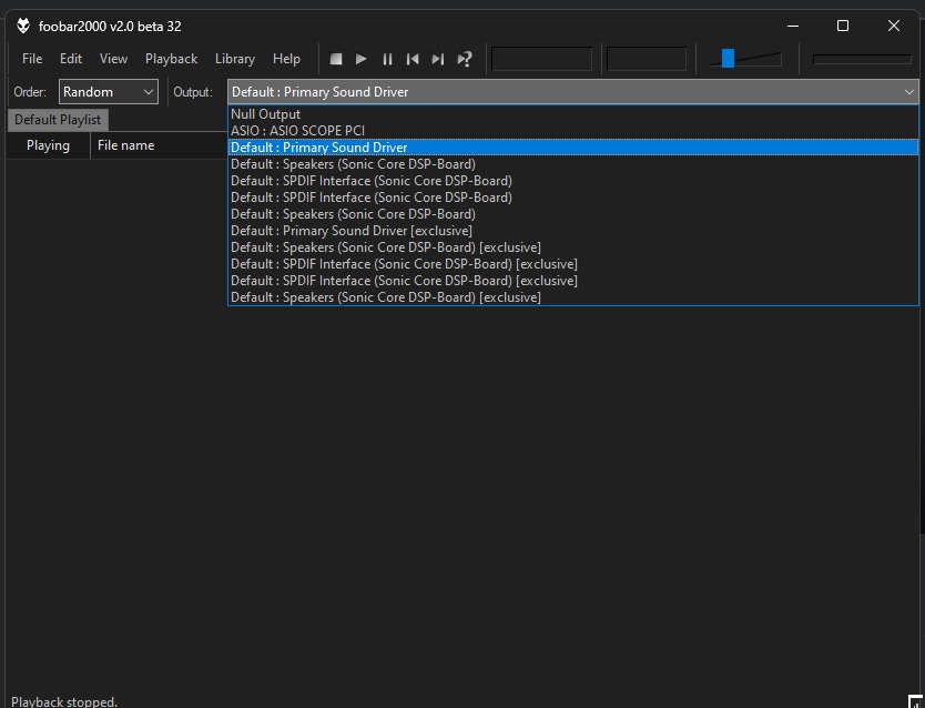

fidox
Posts: 850
Location: Slovenia
Re: No recording scope v7
Post by fidox »
