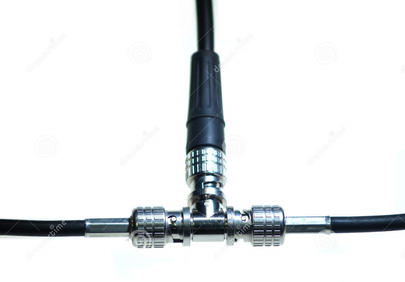

BNC, by specification, is never connected with a cable to both exposed connections. Because the cable itself has to be terminated to avoid reflections, a T-connector is used.
If space is constrained, you can connect this to the host with a pigtail as in the following image:
This can be confusing because as electronics became more tolerant (and as designs did) devices often included measures to ensure self termination. RME for instance does this.
