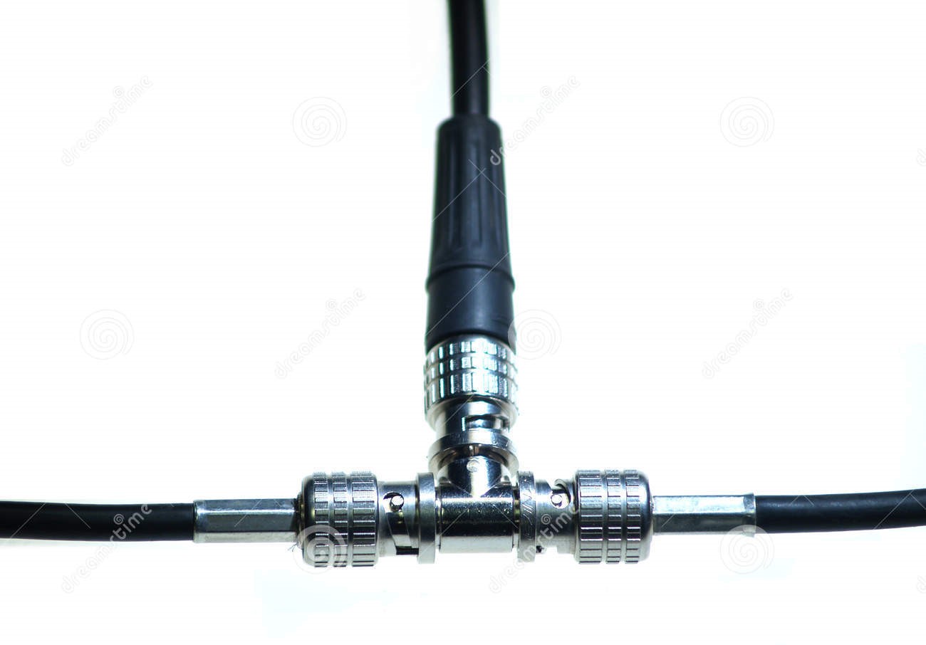

BNC, by specification, is never connected with a cable to both exposed connections.  Because the cable itself has to be terminated to avoid reflections, a T-connector is used.
If space is constrained, you can connect this to the host with a pigtail as in the following image:
This can be confusing because as electronics became more tolerant (and as designs did) devices often included measures to ensure self termination. RME for instance does this.
The #1 best upgrade for my studio was a master clock with multiple (distrubted) outputs. Compared to that, having to buy the proper cables and connectors and properly connect everything was immensely worthwhile.

Hmm, I'm just running a straight cable from my master clock into the devices.
I might look into getting some of those T adapters and terminators.
