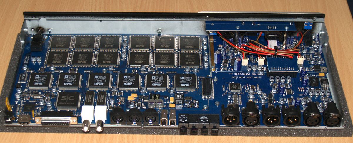

So, the "plop" doesn´t appear on XITE´s balanced analog outs on the rear panel ?
The mic/Di (and phones) connector board is a daughterboard of XITE-1´s mainboard.
When under warranty still, you might need a replacment easy to exchange.
When it´s out of warranty and you have some tech skills (or one of your friends has), open XITE, have a look and investigate.
This board is small and easy to ship as it is relatively easy to install WHEN you or the friend aren´t tech greenhorns.
