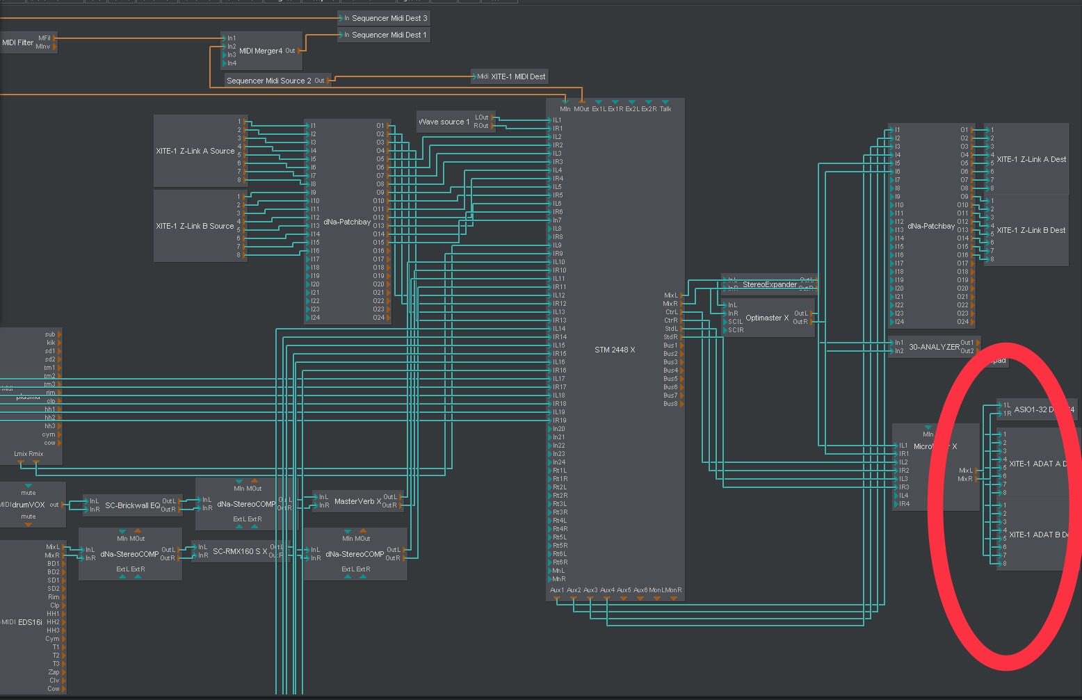

I'm facing a simple problem, which I cannot solve for 2 hours now:
I try to get Ch01 on CTRL-Output.
Setting to mix gives full output, but setting to monitor give just silence.
What is missing ?

Here are some more pics.
I use VU-meters of micromixer to check for output signals.
Selecting "mix" gives signal, but selecting monitor just silence.

From the 2nd pic - mon L and mon R are not connected on the stm2448 (bottom right on stm2448 in routing window)

I attached micromixer to monitor, and now everything works.
Ctr and Std never gave a signal and now I can control them, just like I expected.
It doesn't seem logic to me, maybe it's a miracle in christmas time :wink:
Here's a screenshot of the setup, when Ctr and Std delivered signals...
Thank you again, for your help.

nebelfuerst, I’m wondering how do the connections work in the highlighted area. It appears to be 8 identical stereo channels or 4 identical stereo smux (92khz) going to adat
I mostly configure the adat inputs as 16 mono channels or 8 mono smux (92khz)
If connecting the adat inputs to stereo signals, I have 8 different stereo or 4 different stereo smux (92khz)
I guess I’m wondering how using multiple identical stereo channels benefits adat better than a single stereo channel?

@Berny: The Adat goes to a RMEcard with bitwig under linux. I had some trouble getting the channels in the RME-driver right, so I flooded all channels with signals.

I'm guilty of abusing ctr to extract one channel out of 2448 to an external PC.
Therefore I did't have any need to connect anything to mon.
It works like Spielraum explained. It seems to be a DSP saving mechanism connected to MON, which affects CTR and STD, too.
On first screenshot, there is nothing comming out of STD and CTR.
On the second screenshot, I connected one Mon to a device.
Now STD and CTR immediately deliver stereo output.
