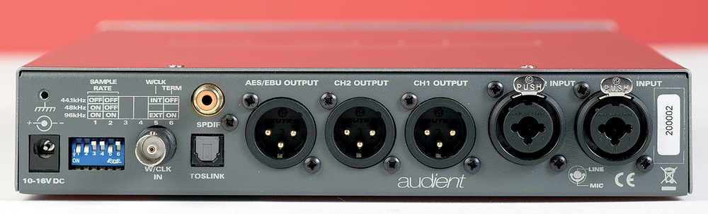

I have a system with three Pulsar cards. Two have SPDIF digital inputs (phono) and one AES (xlr) on the breakout cables. I have a mic preamp with digital outputs i'm trying to get to work through the Scope digital inputs. The preamp has AES and SPDIF outputs and I've tried both without success. I know the SPDIF works as I ran it into the digital input of a DAT player successfully.

It's an Audient Mico (discontinued now) and it's pro quality. It can be slaved via wordclock but I'll try it as master.

I don't see the manual offhand, but it looks like the unit supports quite a few options so you should be able to slave it to Scope.
Looking at the above pic, you can see the sync & samplerate settings on the left. Reading this page shows that the unit can sync to "External Sample Rate: Any between 32kHz and 192kHz"
This page shows the available sync settings and also indicates you can have optical & (RCA) spdif going at the same time.

Well - that worked thanks. Yes the Scope system needs to be in slave mode.
I'm stil sorting out thew various combinations of optical, coaxial and AES/EBU and the various sync sources but I have a working system.
It's interesting that Mico has a slight compression on its analogue outputs compared to the coax digital. I guess it's just a product of the circuitry, the digital must be using the Mico A/D converters and the analogue the Scope converters.
I'm off to investigate the Toslink next, either the Scope optical inputs or the RME ones. I also have a couple of RME cards in other computers although they aren't part of my main recording setup.
It looks like the Mico external sync is only from its BNC wordclock input so I would have to add a wordclock master to achieve that. Presumably the Pulsar cards would slave to an external master clock similarly to how they slave to Mico.
