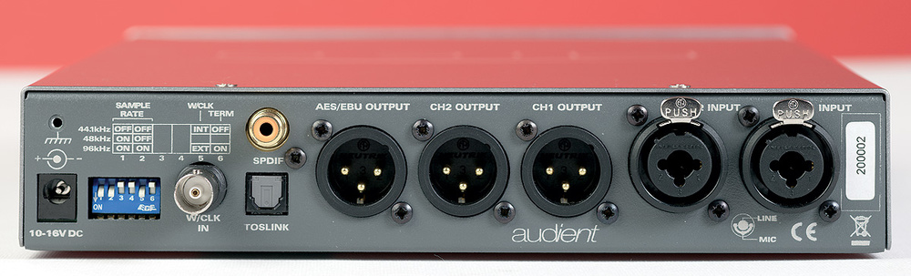

I don't see the manual offhand, but it looks like the unit supports quite a few options so you should be able to slave it to Scope.
Looking at the above pic, you can see the sync & samplerate settings on the left. Reading this page shows that the unit can sync to "External Sample Rate: Any between 32kHz and 192kHz"
This page shows the available sync settings and also indicates you can have optical & (RCA) spdif going at the same time.
Checking the Audient site also shows this little tidbit: https://support.audient.com/hc/en-us/ar ... -Recorders
I don't recall if Scope supports the 'professional' bit set on SPDIF, but I know that I can toggle that setting on my RME interfaces and I switch them to ON to connect that to AES on Scope. So maybe converting to AES (RCA > XLR with the right ohm load) will work if nothing else does.

Well - that worked thanks. Yes the Scope system needs to be in slave mode.
I'm stil sorting out thew various combinations of optical, coaxial and AES/EBU and the various sync sources but I have a working system.
It's interesting that Mico has a slight compression on its analogue outputs compared to the coax digital. I guess it's just a product of the circuitry, the digital must be using the Mico A/D converters and the analogue the Scope converters.
I'm off to investigate the Toslink next, either the Scope optical inputs or the RME ones. I also have a couple of RME cards in other computers although they aren't part of my main recording setup.
It looks like the Mico external sync is only from its BNC wordclock input so I would have to add a wordclock master to achieve that. Presumably the Pulsar cards would slave to an external master clock similarly to how they slave to Mico.
