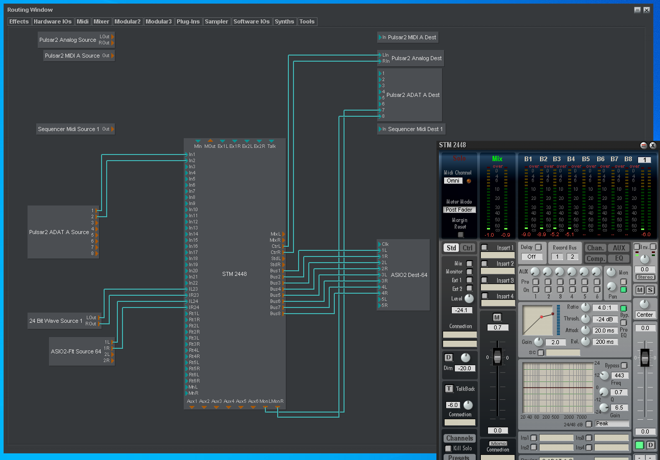

I am trying to get right I/O's in cubase to be able to record audio
Re: connecting scope and cubase for audio recording
Posted: Mon Feb 10, 2020 7:04 pm
by jasonh
Pulsar2 ADAT A Source is a Behringer ADA 8200 Mic pre and AD/DA converter

with all due respect, he has the mixer set up properly, my Washington homie.
the Cubase track is set up properly.
there is a problem with the idea of setting up outputs, when you want to get things IN to Cubase.
post screensjhots of your ASIO busses and driver setup for CUBASE.
the Cubase mixer and channel should show level when record enabled and when there is meter activity in Scope. you should see level in the bus meters when the STM2448 channel is assigned correctly.
Jason, this stuff is no different than having a mixer and a tapedeck in the room with you. you already know how to use those things. i've seen you connecting guitar pedals to an amp. same thing. you have to trust that it works and that it's not voodoo. you would never connect the output of a mixer to the output of a tape deck...
i think you are VERY close to happiness!

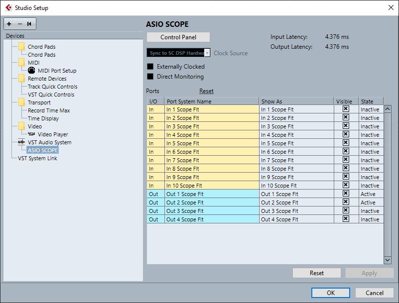

Asio Scope.png (56.19 KiB) Viewed 7810 times
Studio setup 1.png (34.29 KiB) Viewed 7810 times

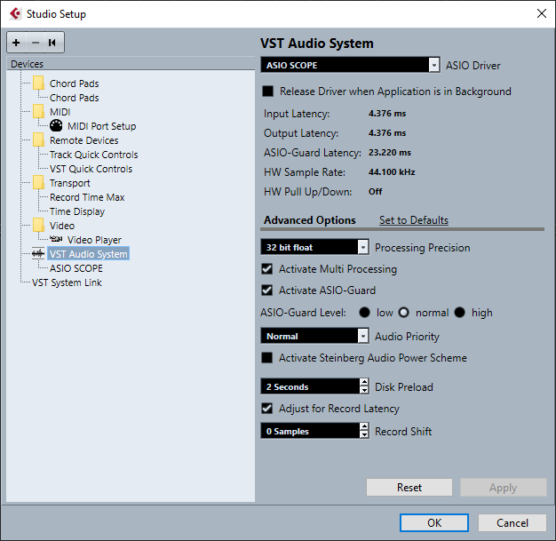

by jasonh
VST Audio.png (46.86 KiB) Viewed 7809 times

by jasonh
In ASIO Scope window, why are Ins inactive?

Jason, you need to go to the audio connections(used to be called vst connections) page and create the bus, if it's not there) and then be sure that Stereo In left(or whatever the exact name is, you can change it) left shows ASIO Scope left or One and that Stereo In Right shows ASIO Scope right or Two. clicking on the section "device port" should give a drop-down where you can choose the input port. i don't remember if it was a right or left click.
normally these ports are chosen automatically, in order, but you can set them to what you want to. apparently, somehow the settings were lost. that's why those ports show as "inactive" in the driver setup window. if you want to use more than the default number of channels(2), then you need to "add bus" either input or output. use stereo busses, even though you can add mono ones. stereo busses work just like mono busses if you only use one channel. left is independent of right unless there's a pan control between them.

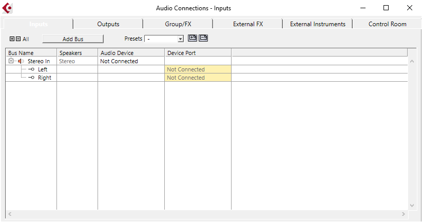

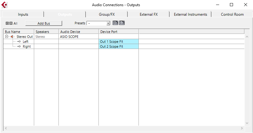

by jasonh
ASIO outputs.png (14.25 KiB) Viewed 7707 times
ASIO inputs.png (14.17 KiB) Viewed 7707 times
can you possibly walk me through it?

Posted: Tue Feb 11, 2020 2:30 pm
by fra77x2
Please go to the Audio setup -> "VST audio system" -> ASIO SCOPE and at the "Ports" turn the "state" of the I/O ports named "In1 Scope Flt" and "In2 Scope Flt" (the first two entries) from inactive to active by clicking on the fields. Then it will apppear in the "Audio connections" panel where you will be able to assign as an input bus these inputs.

Thank you
.I did just that but they are not changing from inactive to active
Posted: Tue Feb 11, 2020 7:32 pm
by jasonh
I think I just figured it out
Audio connections-inputs were 'not connected'
there was a drop down
set inputs to in 1 and 2
