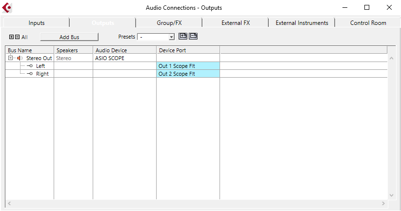

I am trying to get right I/O's in cubase to be able to record audio
				- cubase window.png (103.04 KiB) Viewed 7802 times

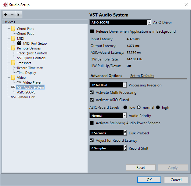

In ASIO Scope window, why are Ins inactive?

Jason, you need to go to the audio connections(used to be called vst connections) page and create the bus, if it's not there) and then be sure that Stereo In left(or whatever the exact name is, you can change it) left shows ASIO Scope left or One and that Stereo In Right shows ASIO Scope right or Two. clicking on the section "device port" should give a drop-down where you can choose the input port. i don't remember if it was a right or left click.
normally these ports are chosen automatically, in order, but you can set them to what you want to. apparently, somehow the settings were lost. that's why those ports show as "inactive" in the driver setup window. if you want to use more than the default number of channels(2), then you need to "add bus" either input or output. use stereo busses, even though you can add mono ones. stereo busses work just like mono busses if you only use one channel. left is independent of right unless there's a pan control between them.

Please go to the Audio setup -> "VST audio system" -> ASIO SCOPE and at the "Ports" turn the "state" of the I/O ports named "In1 Scope Flt" and "In2 Scope Flt" (the first two entries) from inactive to active by clicking on the fields. Then it will apppear in the "Audio connections" panel where you will be able to assign as an input bus these inputs.

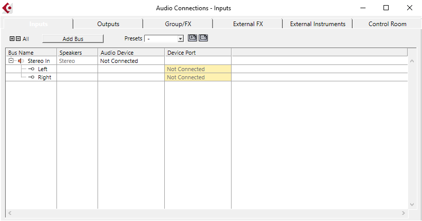

I think I just figured it out
Audio connections-inputs were 'not connected'
there was a drop down
set inputs to in 1 and 2
