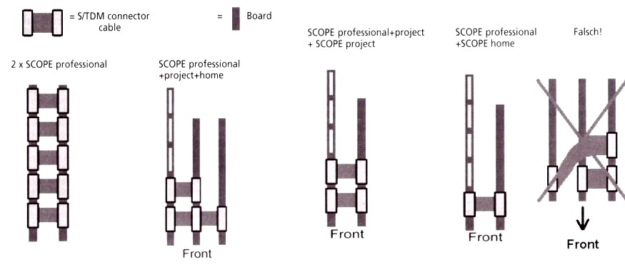

Ok so I understand this correctly, the 2x pulsar 2 card I have have 2 connectors and are PROJECT cards?
- do I need 2 cables for them? They seem to work together with 1 cable..
The pulsar 1 has 1 connector
so to connect the 2x pulsar 2 cards (PROJECT?) and the Pulsar 1 (HOME?) all together I need 2 cables - like example 2 (SCOPE Professional + Project + Home)?
Thanks!
Re: Scope STDM cable
Posted: Tue Feb 19, 2019 1:46 pm
one cable should be sufficient.
just connect them all via the "front" connector, which is the one closest to the back of the case.
