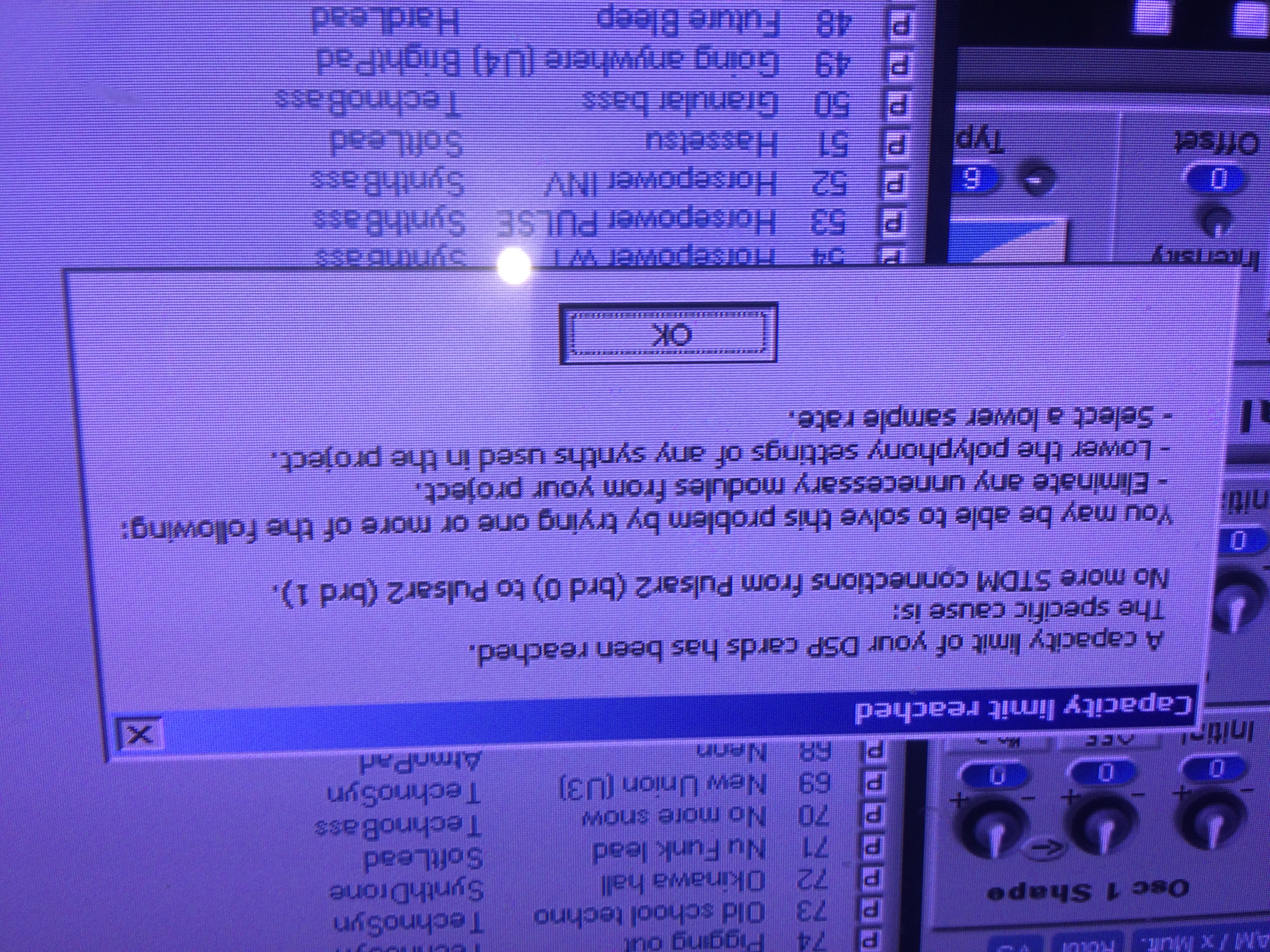

Hey guys thanks again for the advice on the cable.
I've managed to take pictures of the error messages that i'm getting when I put the pulsar 1 into the system with the 2x pulsar 2 cards. I mainly get this message with the solaris 5.. maybe also the rotor ex?
Any idea if these errors are related to me only using 1 cable, or if not what the problem could be? Like I said before, i have no problems if i just use 2x pulsar 2 cards.
Thanks.

Re: Scope STDM cable
Did you check IRQ-sharing?
Maybe your P1 shares an IRQ with an other controller...
If not you could try to clean your PCI-connector with alcohol.
what are you adding?
all resources are limited. the problem with Solaris and other Bowen synths is that they use a lot of resources. it's likely that the project you are using forces the synth to use dsps across both cards, because a big patch with a lot of voices can easily fill 6 dsps. when the dsps are physically too far apart, the slight latency between dsps can make the patch impotent. does reducing voices or simplifying the project help?
Set the patch to a single voice and watch the DSP meter. The Exception error might as well point to a hidden bug in the synth's routing. Solaris is one of the most complex Scope synths and such things may happen.
(if it's not triggered by overloading as mentioned)
