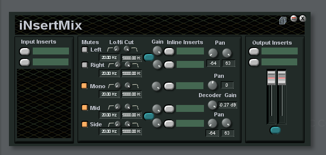

				Hi There,
Attached is a little plaything for those interested.
Stereo input (2 Fx inserts) - Inline inserts for left, right, mono , mid and side channels, all remixed to stereo output (2 Fx inserts).
Inline channels have Lo and Hi cuts and mute buttons.
There is also separate outputs for Mono, Mid and Side if you wish to use them.
I hope its useful for you
regards
maus

				Thank you very much

				Love the idea.
Thanks Maus

				Thanks.  Nice device for the arsenal

				This works great at older great sounding effects that get phasing in the AUX Channels.
So it's a phase alignment tool also.
Really brilliant idea Maus.
Where's your donate button?

				Love the idea! this looks pretty cool! will try for sure.
Curious, what do you guys insert in the Mid n SIde sections? just EQ? Saturation?
				Re: iNsertMix
				Posted: Mon Aug 21, 2017 6:22 am
				by FernandoHood
				share some cool tricks/examples on how to get the most of this plugin

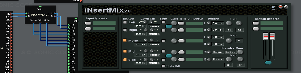

				Hi There
I have updated iNsertMix somewhat adding solo's for each channel and short delays can now be inserted.
Originally I envisaged that this plugin might be able to allow me to add reverb to side signals, whilst maintaining well defined mids.
It grew somewhat from this idea.
It has not been all that good at doing this so far but it has many other possibilities to explore.
Version 2 allows a some delay in each channel to straighten up stereo mixes, sorting out minor phase issues and delaying effects if needed, etc.
The solo function makes it a little easier to set things up.
Hope this is useful.
Regards maus

				Cool ....
Btw - maybe now you can try to put reverb on the mid channel and then Haas delay the output to become side information ....
(I have a "Reverbed Techno kick" effect in mind)
And Thanks again !

				P.S.
Gating or sidechaining the reverb after the Hass delay will make the "Hassiness" less noticeable

				nice! love the new delay per ch Feature

				Well I was inserting Delays now I just run my SE-02 into this.
Since it's a recreation of the Moog Ladder Filter and exactly like it, higher resonance settings sadly attenuate the volume drastically.
Linked fader on the iNsert Mix make it my perfect SE-02 Sub mixer now.
Cranking up the faders and adjusting the rest of the volumes per preset is easy.
Thanks Mau.
