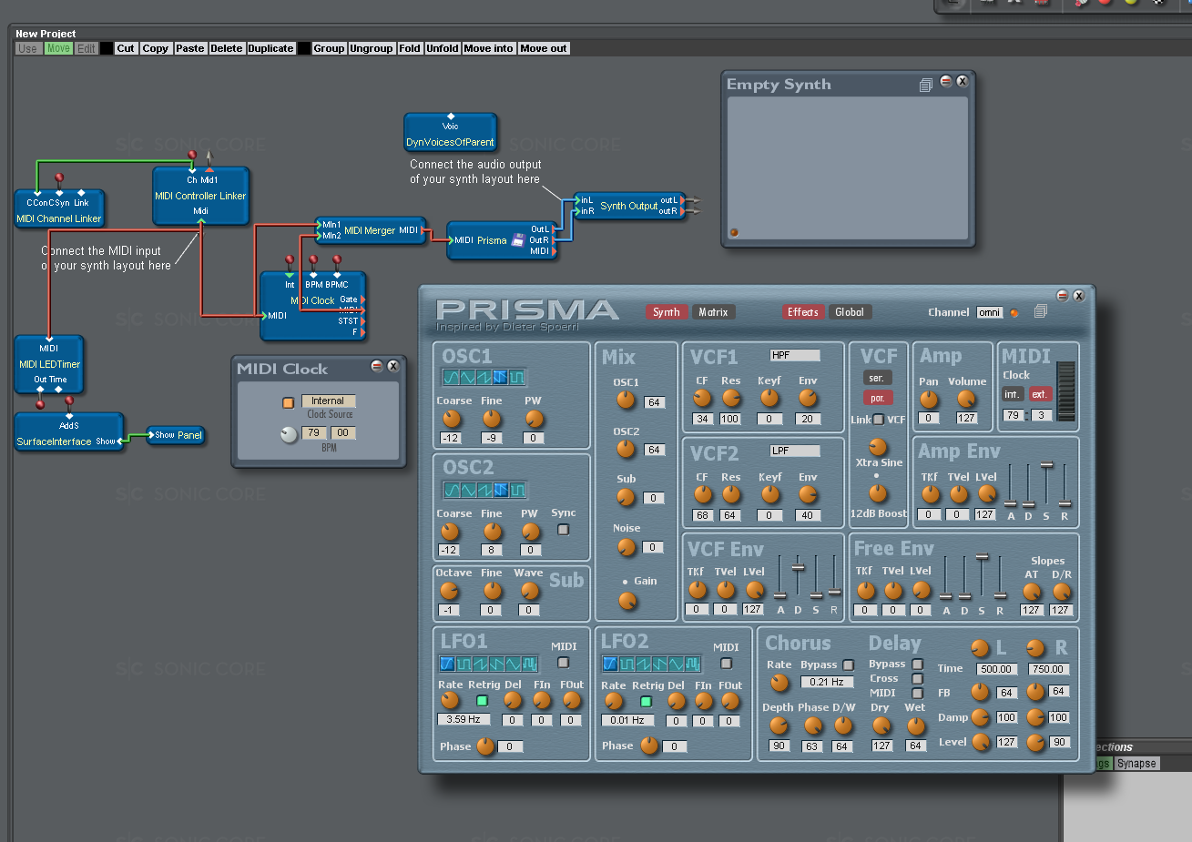

				Actually I have loaded Prisma synth into SDK
Any instructions of how to assign midi at "BPM Coarse text???

				Re: how to make tempo BPM midi assignable in synths with SDK
				Posted: Sun Jun 11, 2017 9:44 pm
				by mausmuso
				Open an empty synth module
Place a synth inside (eg Primsa)
Place a Midi clock inside & connect as shown (with a midi merger)
Adjust clock knob to adjust the synth's BPM
You should be able to cc the knob to adjust the BPM from a sequencer
What would be nice is to place the synth of your choice in a insert slot and have the knob on the front panel next to the insert slot.
Then we would have a useful device.
I might have a look at that.
maus
- BPM Adjust.png (607.1 KiB) Viewed 7739 times

				mausmuso thanks.... I am trying to do it....
so far I have stuck ... in something.... I cannot find midi controller linker, midi led timer, midi channel linker,,, where are these devices?
				Posted: Mon Jun 12, 2017 12:21 am
				by mausmuso
				Hi There,
All of those module are already inside the 'empty synth' module:
C:\Program Files\SCOPE SDK XITE\Design\Device Design\Empty Synth.mdl
I just dragged the Prisma and the MIDI Clock and MIDI merger modules inside the empty synth module in SDK and connected them up.
I think Prisma would have to be set to Ext and the MIDI Clock module to internal to make this work.
In the end I imagine we would have the Prisma panel to manage the synth settings and a second Midi Clock panel where you can set the CC control.
When I get a moment I might have a go at finishing something for you.
Regards
maus
				Posted: Mon Jun 12, 2017 1:05 am
				by mausmuso
				The attached is a simple MIDI Clock device called MIDI Clocker.
Place this in front of you synth midi input and open its panel and cc the knob.
You need to set the synth to Ext and it should work - does for me.
Hope this is what you were after?
maus
				Posted: Sun Nov 19, 2017 3:28 am
				by faxinadu
				you can't do it since the device is locked. you are just opening a locked device in sdk, you can't see the inside.
				Posted: Sun Nov 19, 2017 3:40 am
				by faxinadu
				afaik those text modules do not allow for direct midi controller assignment. what you would need to do is add a knob next to the text module, and link between them. then you could assign midi to the knob. but again, you can't do it with a locked device.
its exactly 2 minutes of work... if you get me an open prisma i'll do it
