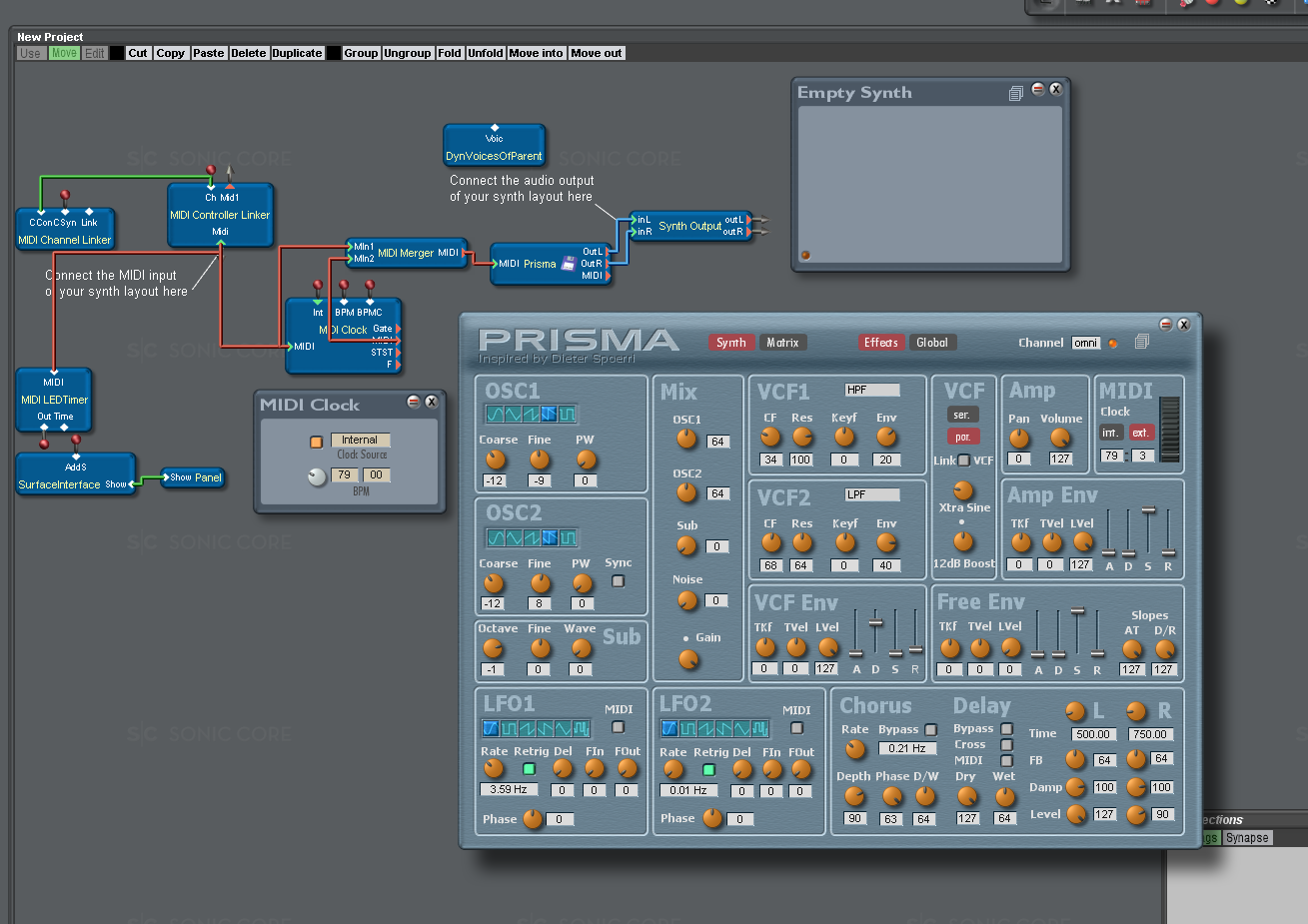

mausmuso
Posts: 543
Re: how to make tempo BPM midi assignable in synths with SDK
Post by mausmuso »
Open an empty synth module
Place a synth inside (eg Primsa)
Place a Midi clock inside & connect as shown (with a midi merger)
Adjust clock knob to adjust the synth's BPM
You should be able to cc the knob to adjust the BPM from a sequencer
What would be nice is to place the synth of your choice in a insert slot and have the knob on the front panel next to the insert slot.
Then we would have a useful device.
I might have a look at that.
maus
BPM Adjust.png (607.1 KiB) Viewed 7606 times

mausmuso
Posts: 543
Post by mausmuso »
Hi There,
All of those module are already inside the 'empty synth' module:
C:\Program Files\SCOPE SDK XITE\Design\Device Design\Empty Synth.mdl
I just dragged the Prisma and the MIDI Clock and MIDI merger modules inside the empty synth module in SDK and connected them up.
I think Prisma would have to be set to Ext and the MIDI Clock module to internal to make this work.
In the end I imagine we would have the Prisma panel to manage the synth settings and a second Midi Clock panel where you can set the CC control.
When I get a moment I might have a go at finishing something for you.
Regards
maus
mausmuso
Posts: 543
Post by mausmuso »
The attached is a simple MIDI Clock device called MIDI Clocker.
Place this in front of you synth midi input and open its panel and cc the knob.
You need to set the synth to Ext and it should work - does for me.
Hope this is what you were after?
maus
