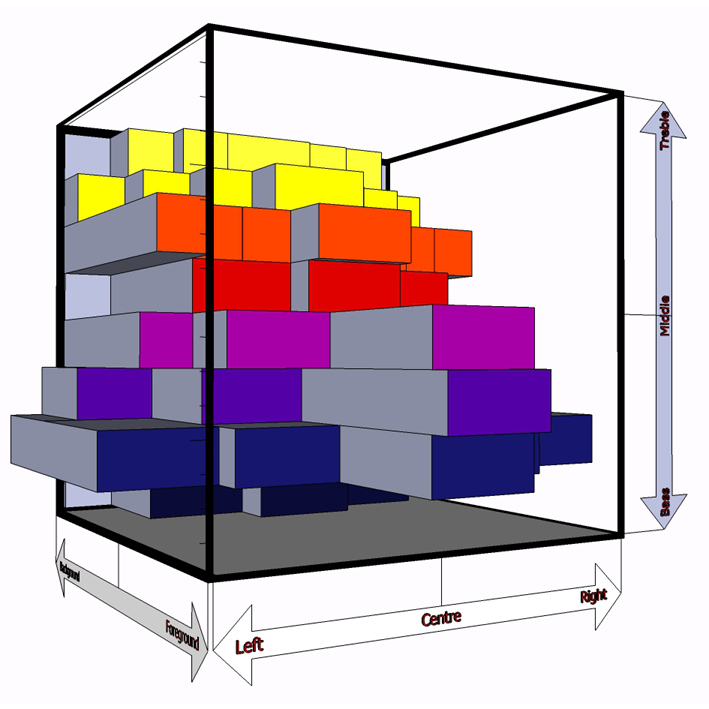

Good advice, but conceptually mastering is about more than 6db and reference tracks. I dont use them, because I want my masters to sound better, and my own sound.
Here http://www.hitfoundry.com/issue_26/scp_mast.htm check out John Paul Braddock 'Mastering the Cube'.
In the movie 'Star Trek Wracth Of Khan' - Khan was defeated because he was thinking in 2D https://www.youtube.com/watch?v=RbTUTNenvCY
Think in 3D - thats a great place to start.
Mastering The Cube
Mastering The Cube
