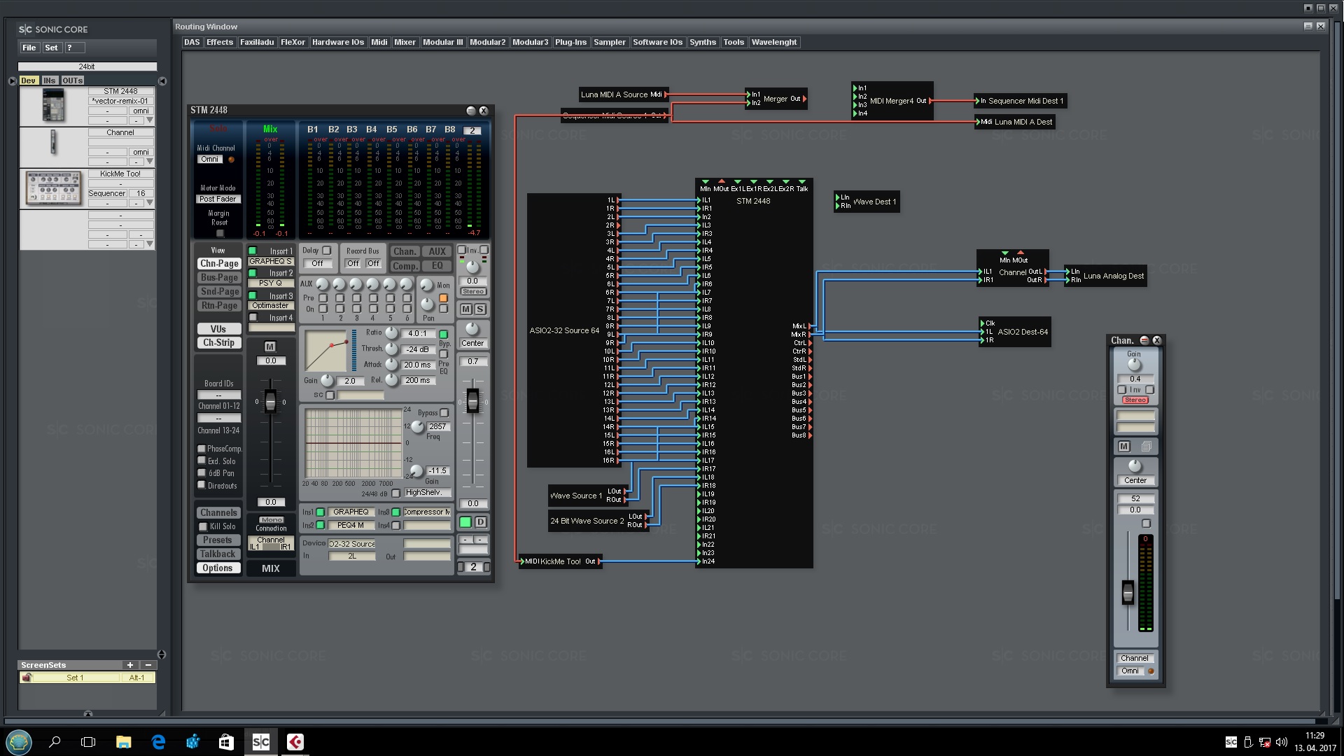

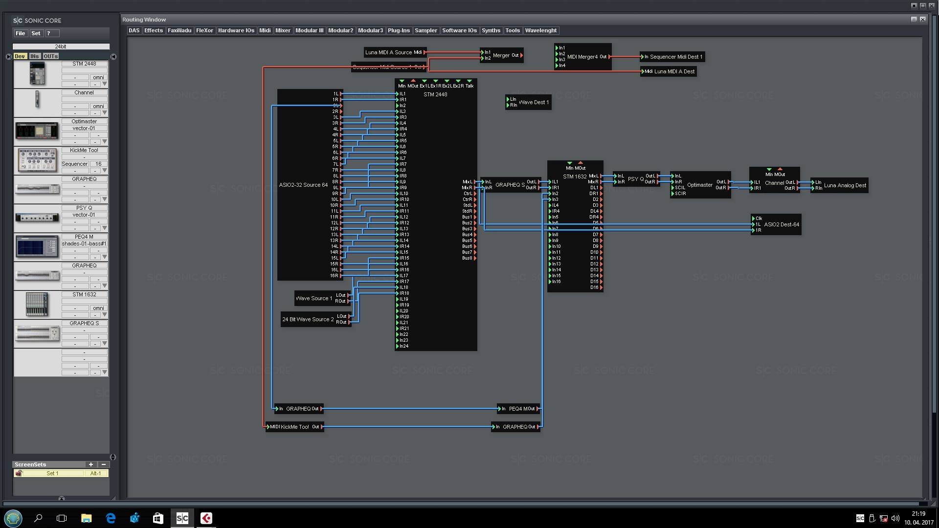

I have attached one picture of my setup, which i'm trying to work with.
that second mixer STM1632 could also be replaced by dynamic or micro mixer , cause i have just 3 channels connected to that mixer.
what i have tried is to isolate bass and drum , so they can breathe and doing eq's separate from other sounds and all other sounds comes from STM2448 (VST's) thru EQ and then to second mixer, from which goes, bass and drum sound too.
is that make any sense ?
can i also replace that grapchi EQ also just with parametric EQ or maybe spectral balance controller ?
Re: Mastering and mixing
what is the real point of the second mixer?
you're not recording the mastered mix, unless it's an external piece of hardware, and the graphic eq on the one ASIO channel could be connected to the STM2448. the mastering tools used could be used with the STM2448.
fidox
Posts: 850
Location: Slovenia
Post by fidox »
garyb wrote:what is the real point of the second mixer?
that was just more like an idea, i didn't use that before.
i wanted to drum (scope) and bass sound (vst mono channel 2) to bypass mixer, so i can eq and editing them separate, from all other sound which comes from Cubas (VST), so i used stereo graphic eq for all those sounds.
in the past i have used too much eq and i didn't get clean sound, but i figured out that lately, cause my ears were used to that
"too much gain sound" and i pushed everything to the sky :)
so, i'm starting from scratch.
i'm getting some nice results already, but still, want to try more.
when i record final mix back to Cubase, i connect ASIO destination to Optimaster, which is not connected atm on the picture.
sure, but you don't need another mixer to do that. of course, it's no problem is you do use another mixer.
also, why not put optimaster and the other mastering devices into the master inserts?
then you can monitor the control room outs, while recording the master out. the advantage to this is that you can raise or lower the control room volume without affecting the master volume(you don't need the control room module).
if you use the monitoring in the STM2448 the normal way that you would in a real studio, with the sequencer being the tapedeck, i think routings will be much simpler and when you get good results, it will not be as arcane a study(figuring out what works well and not).
i'm not telling you that you're doing anything wrong, per se, just giving my opinion.
if you connected the Luna Analog Dest to the Control Room out on the STM2448, you wouldn't need the channel strip as a volume control. the Control Room output has a volume control.
