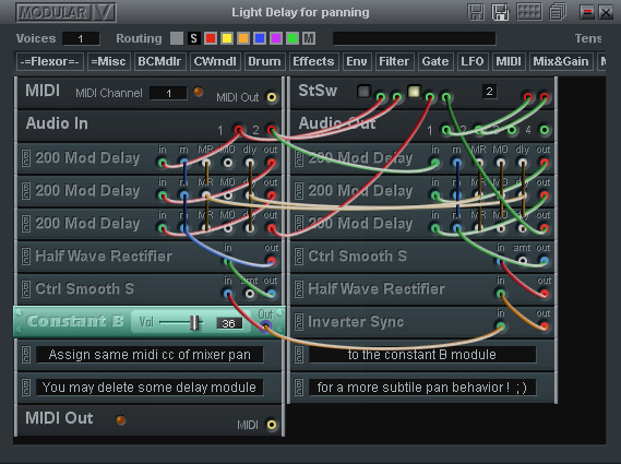

Just assign the same cc you use for mixer pan to the 'constant B' module. You can compare dry/wet with the stereo switch just before audio outputs. Put that patch simply in the stereo signal you want to modulate its pan, at the mixer input.
dly pan.jpg (87.67 KiB) Viewed 20676 times
When left panning, it delays right and with right panning, it delays left from 0 -> 12ms.
Light Delay for panning.rar
(534.88 KiB) Downloaded 617 times

Do you get some good result ?
Here, it work very well, especialy with a continuous pan modulation. With the stereo switch, you can compare with & without the little delays.
