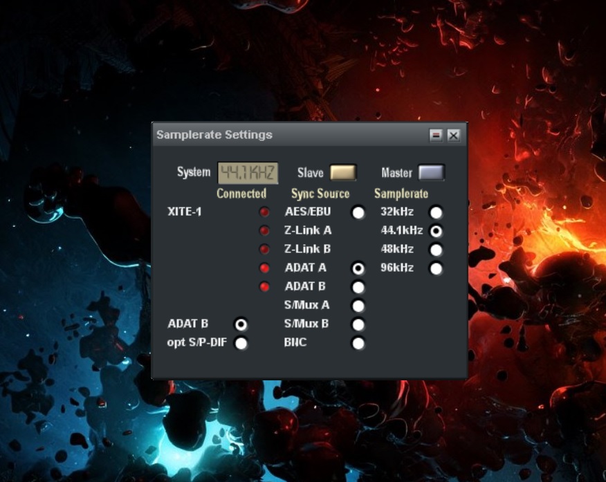

hey Guys im wondering if anyone is using the Audient Asp 880 with the xite
it works perfectly @ 44.1 samp rate but 48, 96 is just clicks and pops
some people were having this problem with the ua apollo and audient has an update to fix that
problem so i sent it back to be updated and its come back but no change it still only works @ 44.1
and clicks galore @ 48, and 96 also it only works @ 44.1 with xite as Slave any insite wud be appreciated
thanks in advance

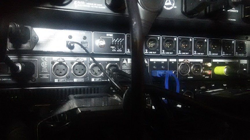

I concur that each of my 3 x TC Fireworx have an issue where the left channel of any mixer has scratchy noise that spikes up to -6db @ 48k.
Also noticed Solaris @ 48k into the ADA8200 with Black Lion Audio modifications does the same thing.
AES/EBU @ 48k is fine.
XITE-1 doesn't seem to like ADAT @ 48k.
Been trying this for 3 days now.
Sometimes it doesnt make the noise.
But it was frequent enough for me to use 44.1k.
Just run Solaris through the ADA8200 upgraded signal paths.

Re: xite 1 + asp 880 adat clicks and pops
Posted: Mon May 23, 2016 5:11 pm
Found the problem....
Using ADAT Out only and set at 44.1k Master on ADA8200 means there's no clock as it isn't needed.
Just sending out info 8 x analog ins on a modded ADA from Black Lion Audio.
TC Fireworz has ADAT A In and out.
Crackling until I set the Sample Rate Window from Master to Slave.
Don't care who is the boss in the set up as long as that rice crisp shit stops.
Now I have XITE-1 Mic Pres working Analog I/O working AES/EBU working and both ADATs working...
AWESOME.....
