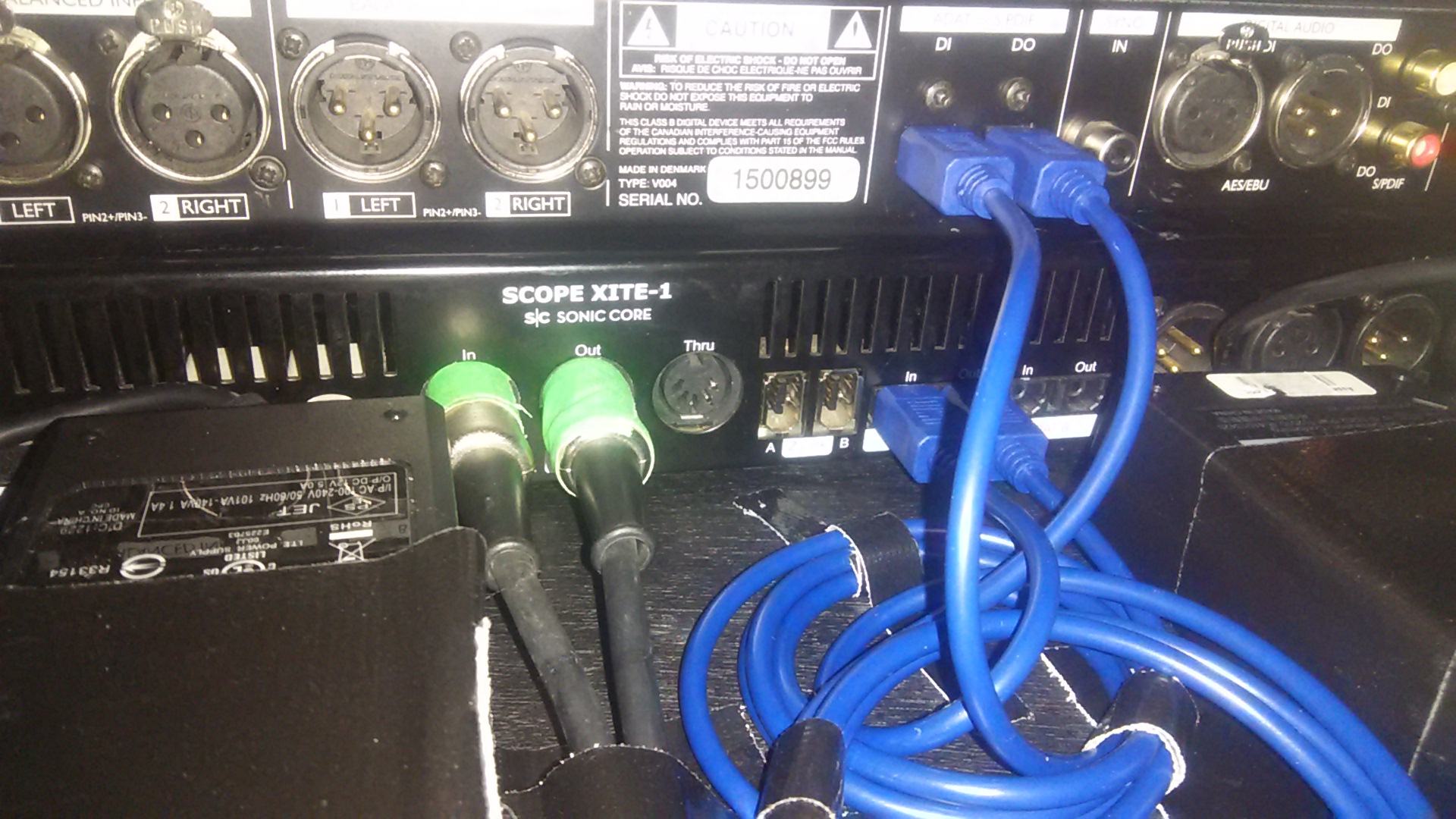

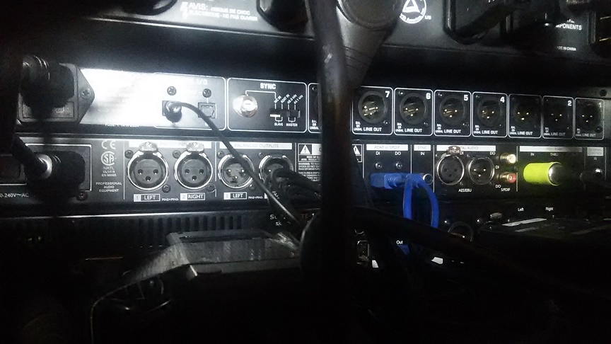

I concur that each of my 3 x TC Fireworx have an issue where the left channel of any mixer has scratchy noise that spikes up to -6db @ 48k.
Also noticed Solaris @ 48k into the ADA8200 with Black Lion Audio modifications does the same thing.
AES/EBU @ 48k is fine.
XITE-1 doesn't seem to like ADAT @ 48k.
Been trying this for 3 days now.
Sometimes it doesnt make the noise.
But it was frequent enough for me to use 44.1k.
Just run Solaris through the ADA8200 upgraded signal paths.

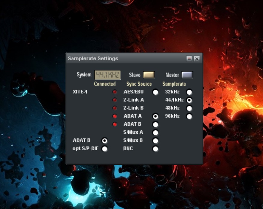

Re: xite 1 + asp 880 adat clicks and pops
Found the problem....
Using ADAT Out only and set at 44.1k Master on ADA8200 means there's no clock as it isn't needed.
Just sending out info 8 x analog ins on a modded ADA from Black Lion Audio.
TC Fireworz has ADAT A In and out.
Crackling until I set the Sample Rate Window from Master to Slave.
Don't care who is the boss in the set up as long as that rice crisp shit stops.
Now I have XITE-1 Mic Pres working Analog I/O working AES/EBU working and both ADATs working...
AWESOME.....
AWESOME.....
Never understood clock very well.
Always assumed all ADAT I/Os had to be connected.
Behringer is weird as it must be set to Master but have no ADAT in connected?
TC Fireworx has no Master/Slave setting it just works out that it is Master once
Scope becomes the Slave.
Im just glad that crackly stuff is gone.
This whole Master/Slave thang is offensive and racist.
No wonder they invented MADI.....
