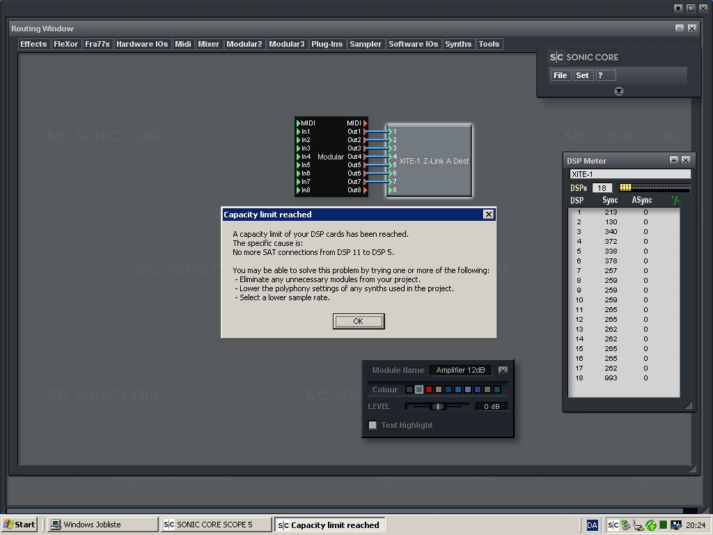

After this, I have had lots of errors in Scope. Here is a "project" I tried to make at 48 kHz. This is from a fresh boot with an empty start up project. I powered off everything before this attempt.
Xite error.jpg (194.89 KiB) Viewed 1928 times

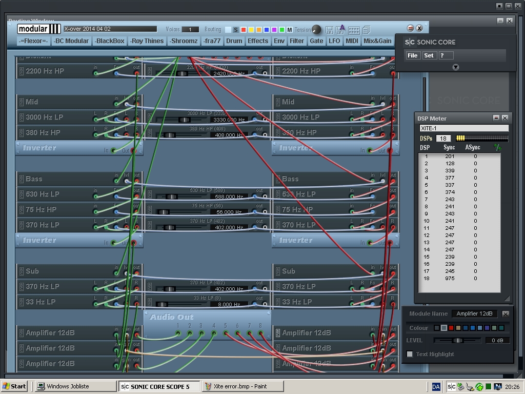

The modular patch has nothing but 6dB filters, attenuators and gain stages in it.
Xite error modular.jpg (431.65 KiB) Viewed 1928 times

I'm sorry. It was in 96 kHz.
