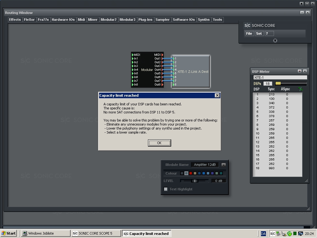

After this, I have had lots of errors in Scope. Here is a "project" I tried to make at 48 kHz. This is from a fresh boot with an empty start up project. I powered off everything before this attempt.
Xite error.jpg (194.89 KiB) Viewed 1925 times

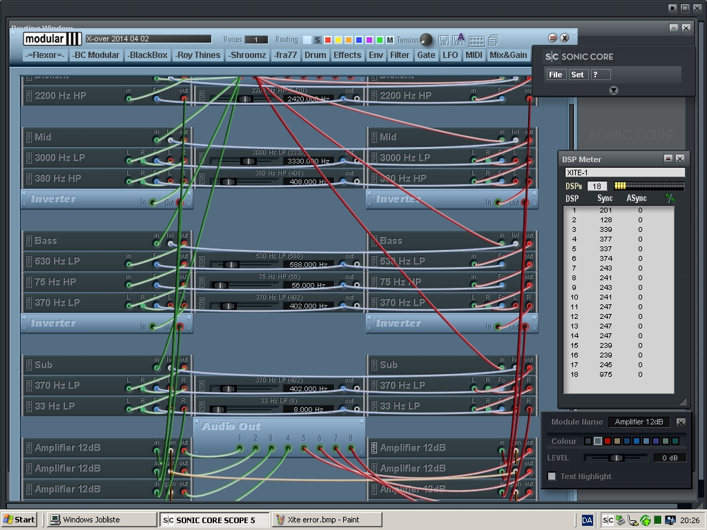

The modular patch has nothing but 6dB filters, attenuators and gain stages in it.
Xite error modular.jpg (431.65 KiB) Viewed 1925 times

I'm sorry. It was in 96 kHz.

I have tried, DSP 1, 2, 7, 8, 11 and 18 (automatic) and probably others too. I noticed something strange. When loading on DSP 1 or 2, I got an error when I tried to raise the trackcount to 32. On DSP 7, I could take it to 56 and got an error at 64. I think I remember these numbers right. It was late. When I tried to assign things (also other modules and devices) to DSP 3-6, I would get error messages immediately.
I think I found an Xite VDAT bug. Can someone check out if they get the same problem? If I connect i.e. a channel module to two of the inputs on VDAT, and then I connect the same channel outputs to more inputs on the VDAT, my PC reboots.
