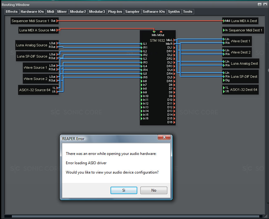

I'm checking out Reaper and Scope 5.1 PCI on Vista x64.
I get an error loading ASIO driver :-?

What is the error? And please post a picture p
Of your scope project :)
Re: Reaper 3.74/64 and ASIO Scope
Posted: Mon Jan 03, 2011 9:45 am
by Cochise

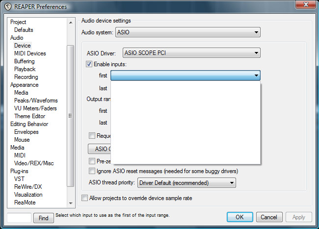

I've tried Reaper 32 in Vista 64 with Scope 5.1 x64...
...ASIO scope PCI isn't even showed in the audio device settings.

What happens if you enable that"Ignore asio reset messages" feature?And maybe after that try projekts can override device sample rate dialog.
Posted: Mon Jan 03, 2011 4:48 pm
by Cochise
No way, till now; in/out channels are not seen... and it's a pity, since Scope and modules look loading smoother and faster in 64 bit environment.

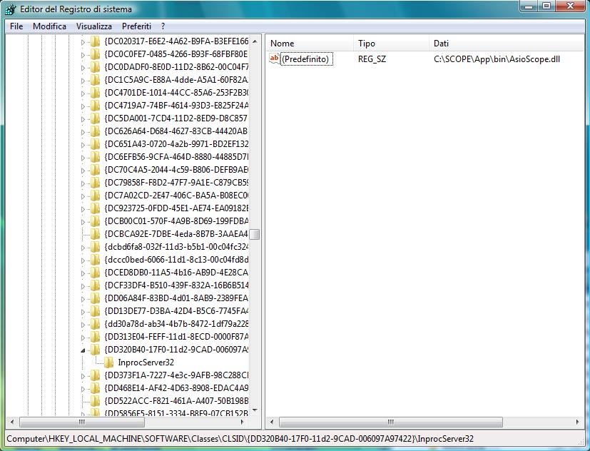

From any of you guys having similar configuration working, maybe it could be useful for me to know what's showed as content in the following registry keys:
HKEY_LOCAL_MACHINE\SOFTWARE\ASIO\ASIO SCOPE PCI
and
HKEY_CLASSES_ROOT\CLSID\{DD320B40-17F0-11D2-9CAD-006097A97422}

Re: Reaper 3.74/64 and ASIO Scope (v5.1 - PCI)
Posted: Tue Jan 04, 2011 3:14 pm
by Cochise
Thx Widy.
Mine is looking this way
Should I change it?
Posted: Tue Jan 04, 2011 3:18 pm
by Cochise
Changed.... WOW! looks like working now!
