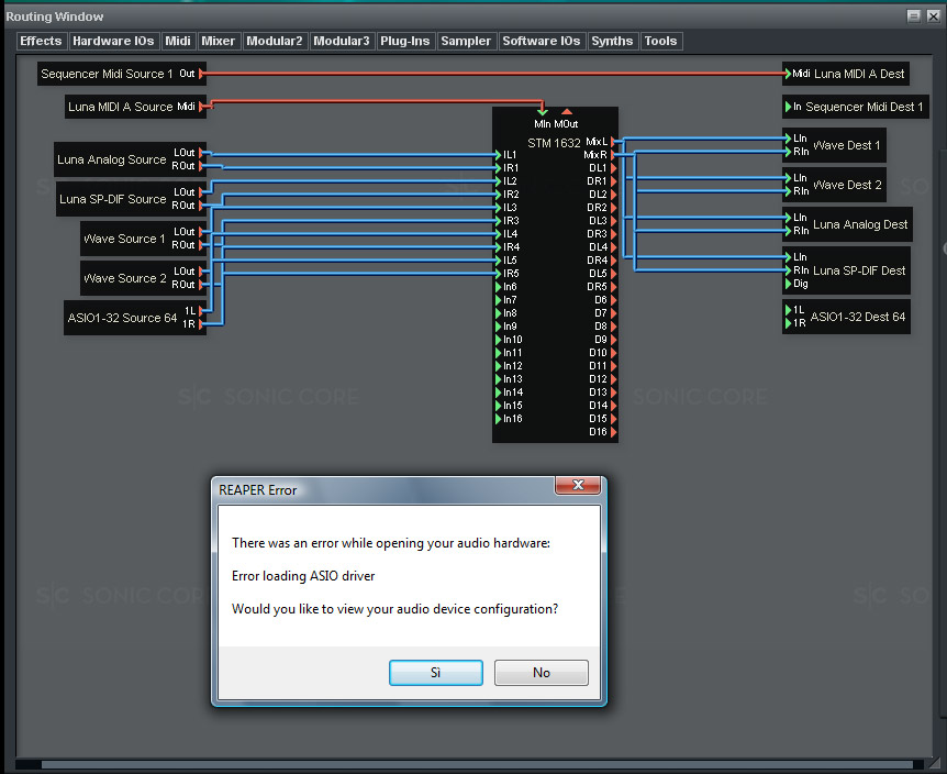

I'm checking out Reaper and Scope 5.1 PCI on Vista x64.
I get an error loading ASIO driver :-?

What is the error? And please post a picture p
Of your scope project :)

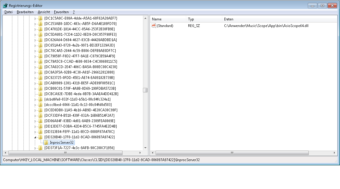

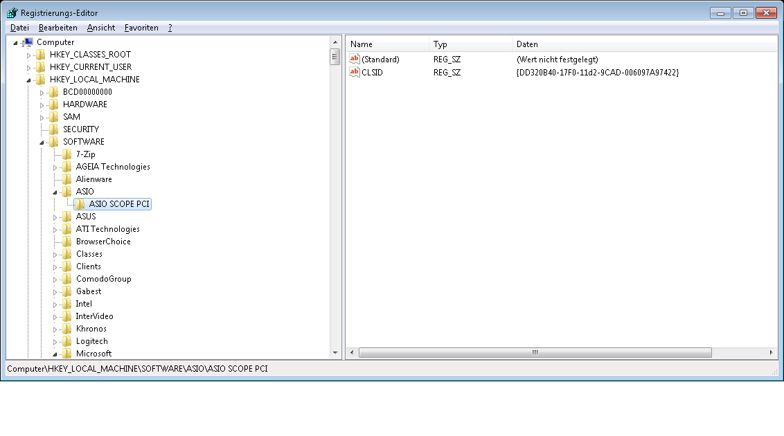

From any of you guys having similar configuration working, maybe it could be useful for me to know what's showed as content in the following registry keys:
HKEY_LOCAL_MACHINE\SOFTWARE\ASIO\ASIO SCOPE PCI
and
HKEY_CLASSES_ROOT\CLSID\{DD320B40-17F0-11D2-9CAD-006097A97422}
widy
Posts: 175
Joined: Wed Apr 07, 2004 4:00 pm
Location: Austria-Graz
Re: Reaper 3.74/64 and ASIO Scope (v5.1 - PCI)
Post by widy »
Cochise wrote:From any of you guys having similar configuration working, maybe it could be useful for me to know what's showed as content in the following registry keys:
and
lg widy

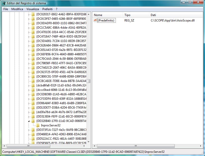

Mine is looking this way
Should I change it?
Cochise
Posts: 1305
Post by Cochise »
Changed.... WOW! looks like working now!
