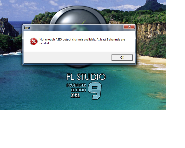

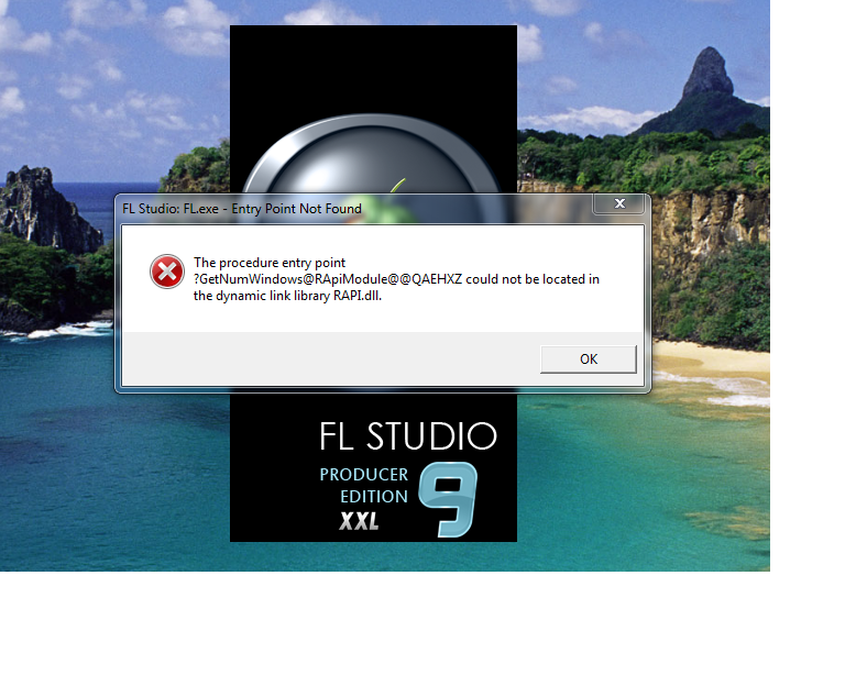

				Hi I'm trying to use XTC mode in FL Studio and I keep getting this error message,
 ( the procedure entry point ?GetNunWindows@RApiModule@@QAEHXZ could not be located in the dynamic link library RAPI.ddl)
Followed by Not enough ASIO channels availible (which iv seen this one b4)
XTC MODE USE TO WORK In V4.5, It just diddnt work properly and now whenever I try to use it in the new V5.0 it not only doesn't work but it doesn't allow me to use FL Studio 9 EITHER and Its VERY FRUSTRATING FOR THE SIMPLE FACT THAT I STOP USING MY SCOPE CARDS FOR 6 MONTHS JUST WAITING FOR THE OFFICIAL COPY TO JUST RUN INTO YET ANOTHER PROBLEM.
CAN ANYONE HELP ME PLEASE!!!!!!!!!!
AND I HAVE A PIC OF THE ERROR MESSAGE BUT NOT SURE HOW TO UPLOAD

				Still didnt work! I saved my files in a back up drive, did a fresh install and didnt even add any of my files I just tested to see if it would work and:
						- 1.0.png (600.93 KiB) Viewed 10168 times
						- 1.1.png (561.67 KiB) Viewed 10166 times
			  and this is all I get EVERY SINGLE TIME, WELL IMA BE BACK ON IT AT WORK TOMORROW AND IF I DONT TRY to use XTC FL STUDIO works fine. its like windows 7 dont want me using the INSTRUMENTS

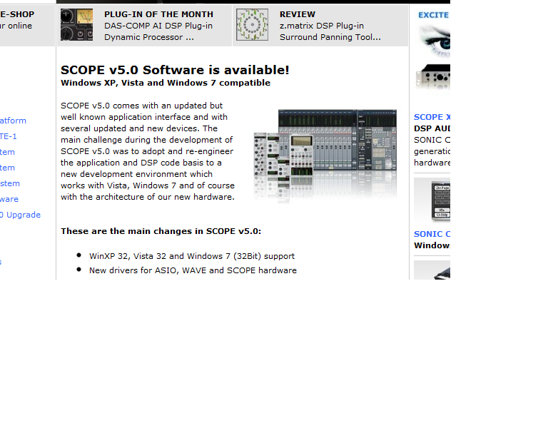

				Yeah I was gonna say the same thing it does work just fine in window 7 32 bit just for some reason my XTC is acting UP.
						- 1.3.png (117.4 KiB) Viewed 10159 times
So...... Any other Ideas, or is there anyone who do have it working in windows 7 XTC, and by the way are there any other problems that are known in windows 7

				I doubt the RAPI error is related to scope. Does this only happen when you launch FL Studio? Do you have any other sequencers you could try? Do the error occur when you launch FL running scope in normal mode?
Registry inconsistencies and virus/cracks might also cause RAPI errors.
EDIT: i take it from your last post Scope is running fine in normal mode, so here's roundup:
For the missing asio error, i suspect this to be because of lack of a proper XTC project.
For the RAPI error, a registry cleaner might help. Do you have any portable devices/PDA's connected by any chance?
