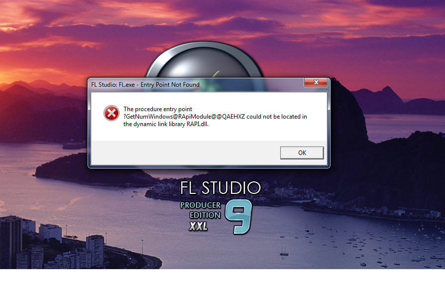

Hi I'm trying to use XTC mode in FL Studio and I keep getting this error message,
( the procedure entry point ?GetNunWindows@RApiModule@@QAEHXZ could not be located in the dynamic link library RAPI.ddl)
Followed by Not enough ASIO channels availible (which iv seen this one b4)
XTC MODE USE TO WORK In V4.5, It just diddnt work properly and now whenever I try to use it in the new V5.0 it not only doesn't work but it doesn't allow me to use FL Studio 9 EITHER and Its VERY FRUSTRATING FOR THE SIMPLE FACT THAT I STOP USING MY SCOPE CARDS FOR 6 MONTHS JUST WAITING FOR THE OFFICIAL COPY TO JUST RUN INTO YET ANOTHER PROBLEM.
CAN ANYONE HELP ME PLEASE!!!!!!!!!!
AND I HAVE A PIC OF THE ERROR MESSAGE BUT NOT SURE HOW TO UPLOAD
file:///C:/Users/REZ/Desktop/FL%20Studio%20Scope%20P1.png
- FL Studio Scope P1.png (932.22 KiB) Viewed 10188 times

mAN nO CIGAR, NOTTA, DidNT WORK! this is crazy i cant use my instruments, how do you edit the xtcproject file

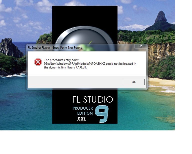

Still didnt work! I saved my files in a back up drive, did a fresh install and didnt even add any of my files I just tested to see if it would work and: and this is all I get EVERY SINGLE TIME, WELL IMA BE BACK ON IT AT WORK TOMORROW AND IF I DONT TRY to use XTC FL STUDIO works fine. its like windows 7 dont want me using the INSTRUMENTS

What exactly do you mean,"For the missing asio error, i suspect this to be because of lack of a proper XTC project." can you clear that up for me because I just did a clean fresh Install and still the same thing, as for having other sequencers, yeah I have Cubase 4 LE that Freezes when I put the SCOPE ASIO driver In, Any freeware registry cleaners you know of... no portable devices hooked up...
