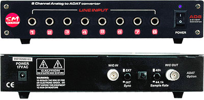

- SM PRO AUDIO AO 8: 8 analog in to ADAT (156 € new)
SM PRO AUDIO AO 8
SM PRO AUDIO AO 8

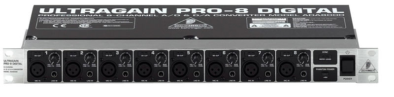

- BEHRINGER ADA8000 PRO-8 DIGITAL: 8 analog in to ADAT + 8 ADAT to analog out (209 € new)
BERHINGER ADA 8000
BERHINGER ADA 8000

The "old" creamware A8 (8in+8out) and A16 (16in+16out) would also do the job if you can get a used one.

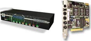

Finally another solution would be to add a Scope Home/Luna 3 DSP board + 1 LUNA 2496 I/O converter (this type of bundle cost me 200 € at the beginning of the year).
Scope Home + Luna 2496 IO
Scope home + Luna 2496 IO.jpg (13.12 KiB) Viewed 3059 times
It would provide you the 8 analog inputs you need (with cinch type connexion though), 8 analog outputs (also cinch) on the LUNA 2496 I/O.
Then you still have the stereo analog input of your scope project and the stereo analog input of the scope Home for futur use.
And you also get 1 extra MIDI IO in case you need two of them (one is already available on your scope project).
And last but not least you would get 3 extra DSP to add to the 6 you have on your Scope Project.
