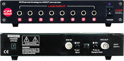

- SM PRO AUDIO AO 8: 8 analog in to ADAT (156 € new)
SM PRO AUDIO AO 8
SM PRO AUDIO AO 8
AO 8.jpg (24.32 KiB) Viewed 3029 times

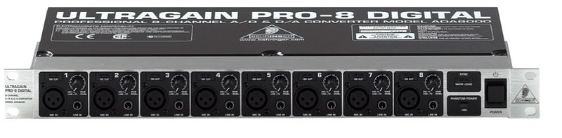

- BEHRINGER ADA8000 PRO-8 DIGITAL: 8 analog in to ADAT + 8 ADAT to analog out (209 € new)
BERHINGER ADA 8000
BERHINGER ADA 8000
ADA 8000.jpg (33.14 KiB) Viewed 3033 times
