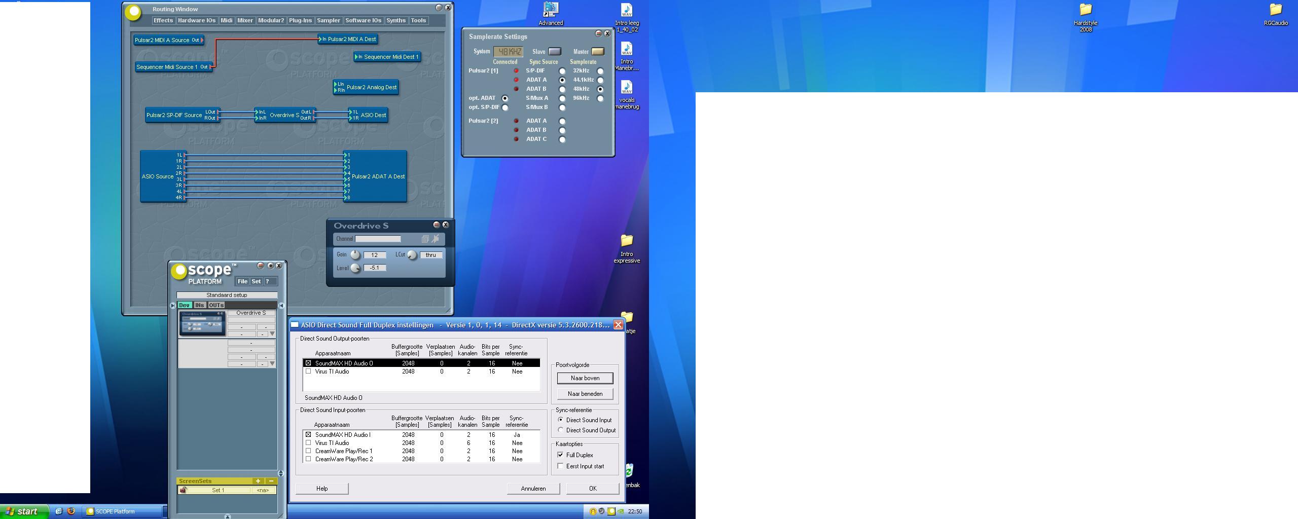

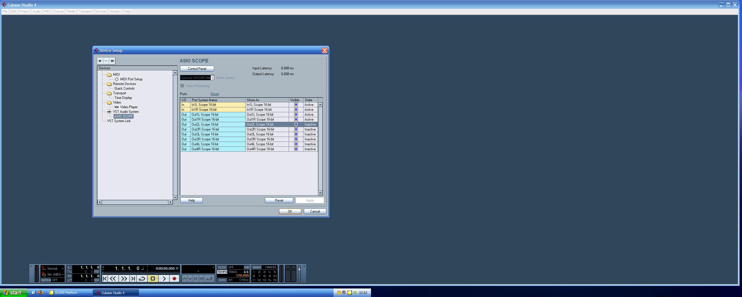

Hi All, problems again
I'm back. Bought an original Cubase 4 studio, downloaded patch 4.52 and the Scope patch for 4.1.
I don's see any scope outputs in the Direct X Full duplex. But when i open Cubase i see the 8 outputs but cannot activate them. please help.

Hi, i don't work in XTC Mode. But when i remove & add Asio channels, they show up in Cubase but they stay inactive :S
Re: Can't get it back to work Scope 4.5 Cubase SX3
Posted: Wed Oct 29, 2008 3:18 pm
also, you must enable i/o in Cubase.
you MUST close Cubase before making changes to the Asio modules in Scope.
