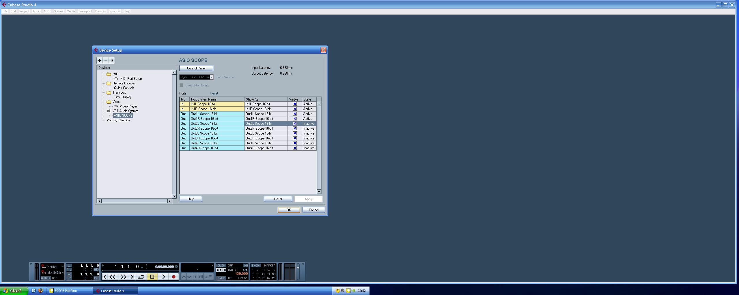

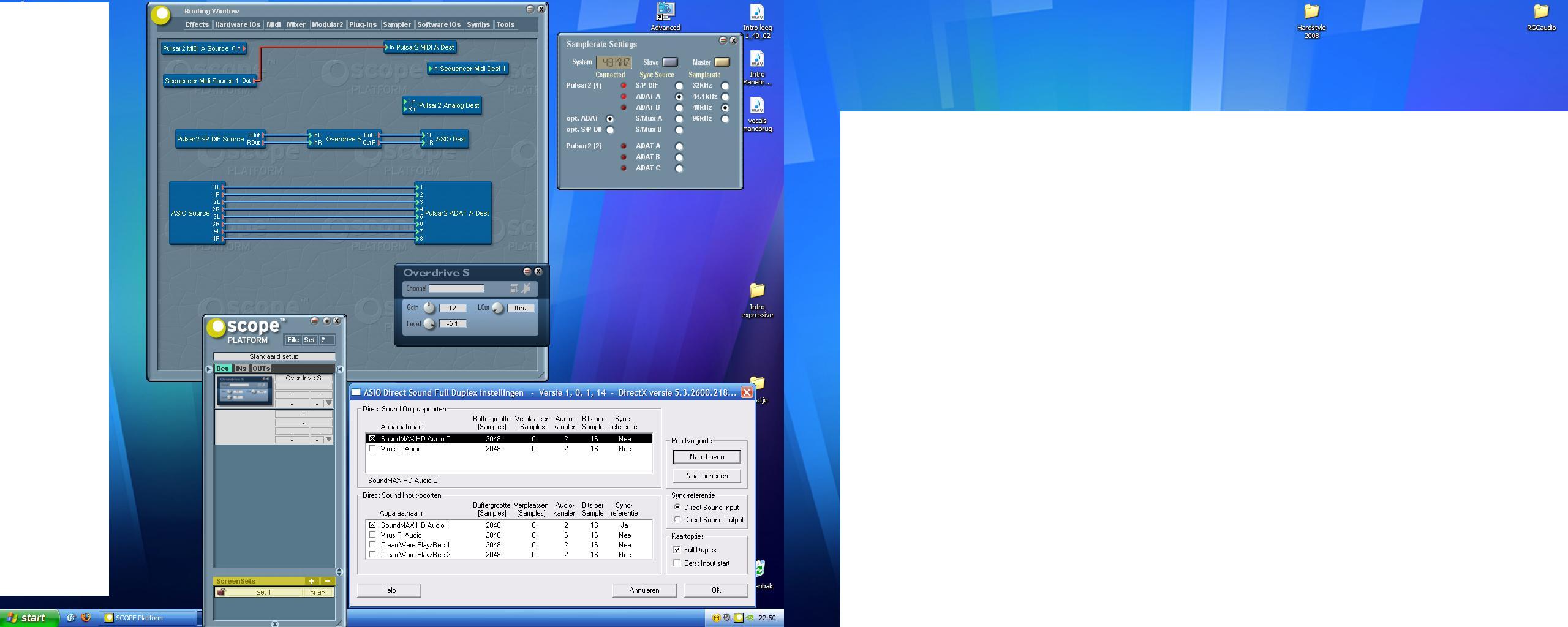

Hi All, problems again
I'm back. Bought an original Cubase 4 studio, downloaded patch 4.52 and the Scope patch for 4.1.
I don's see any scope outputs in the Direct X Full duplex. But when i open Cubase i see the 8 outputs but cannot activate them. please help.
scope no outputs.JPG (202.07 KiB) Viewed 2293 times
cubase shows scope.JPG (171.7 KiB) Viewed 2292 times

Hi, i don't work in XTC Mode. But when i remove & add Asio channels, they show up in Cubase but they stay inactive :S
Re: Can't get it back to work Scope 4.5 Cubase SX3
also, you must enable i/o in Cubase.
you MUST close Cubase before making changes to the Asio modules in Scope.

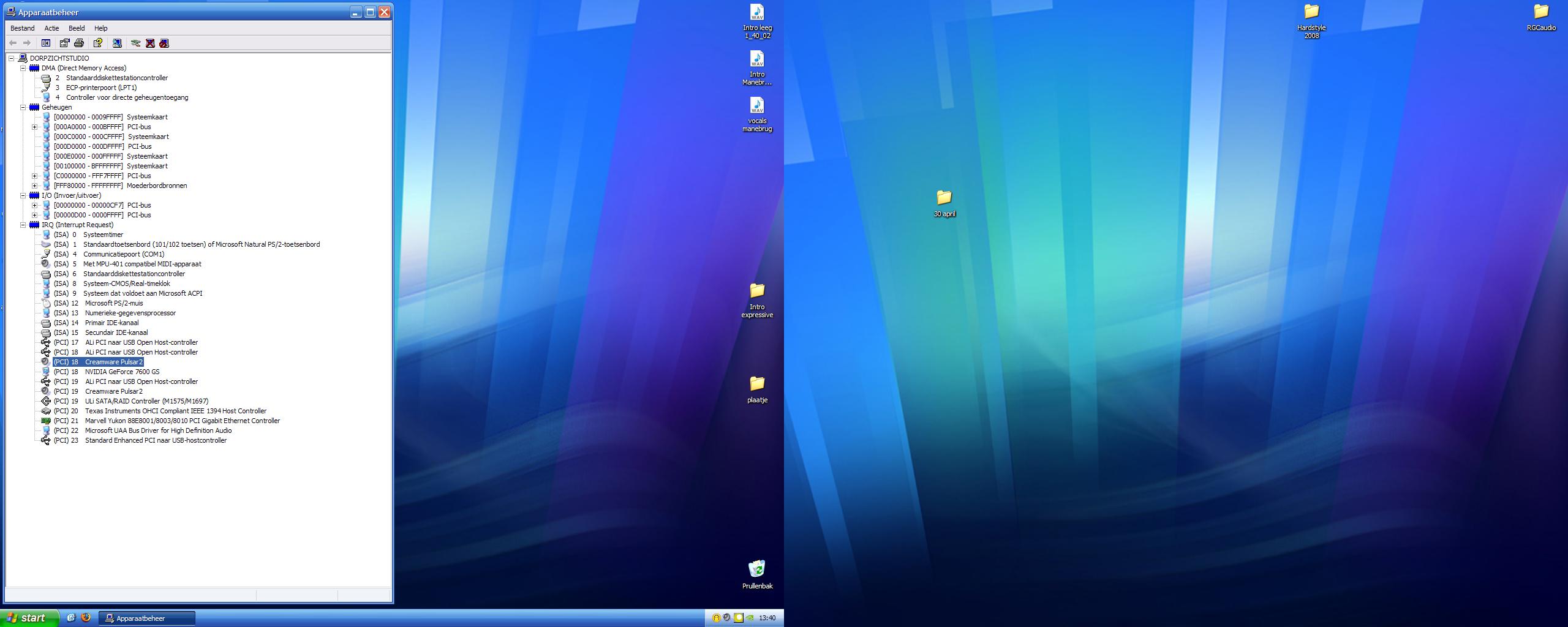

Hi! Still having problems. I'm not using any external midi devices (anymore) Here's a printscreen of my IrQ settings. The pulsar Cards are on 18 + 19. I Use a DDX 3216 still for monitoring (adat) . Never thought about using a scope mixer for output. Just curious, how are your settings to record etc.? Thanks.
it's your motherboard. bad design...
is that an ali chipset? very poor quality...
the graphics card sharing may be fatal. Scope cards generally CAN NOT share irqs. if you have another slot available, you might try it. meanwhile, you must disable the two usb controllers that are sharing with the Scope cards(in the device manager).
if you go to start/programs/accessories/system tools/system information/hardware resources/conflicts-sharing you will find the names of the shared controllers(probably something like 1EA7D or similar). then you can go to the device manager and disable the appropriate controller.
disabling the usb controllers alone MAY fix the problem. if you can find the slot that shares with the graphics and swap the card to another slot AND disable the shared devices afterwards, everything SHOULD be stable.

The Motherboard is an Asus A8R-MVP with Radeon Xpress 200 CrossFire (RD480 + ULi M1575) chipset. The problem i found is the shared usb IRQ. But i need usb for my Virus TI.. I wil try to switch boards. And maybe my VGA into the other SLI slot.. Keep you guys posted. Thanks so far

Hmz.. try to install vga card in other SLI slot, system don't boot. (3 peeps) try to shuffle pci slots, USB is locked to PCI slots i guess. How can i reserve only the pulsar cards to one IRQ number. Have tried some settings in bios but still no succes..
YOU MUST DISABLE A COUPLE OF USB CONTROLLERS. :)
there is NO way to change the irq sharing as it's hardwired into the motherboard and ACPI doesn't allow it. the usb thing is not a big problem and it's quite common. the graphics card is problematic, but hopefully it won't stop the show. does that motherboard only have 2 pci slots? if so, the your only choice is to disable the usb controllers that share with those 2 slots and hope for the best. if you have 3 slots, you can move the two cards around and see if you get a better configuration.
another thing that might help is to go into the bios and disable any ports or onboard devices you don't use such as onboard sound and serial and parallel ports. this might free up enough irqs that some of the sharing disappears.
SLI motherboards are designed for maximum video performance, not maximum pci performance. plainer, more industrial motherboards work much better. intel motherboards and/or at least intel chipsets pretty much always work well. even still, i always have to disable a couple of usb controllers when i build systems with multiple cards. afterwards all, or at least most, usb ports still work in the same way that you can plug several devices into one usb hub into one port...
