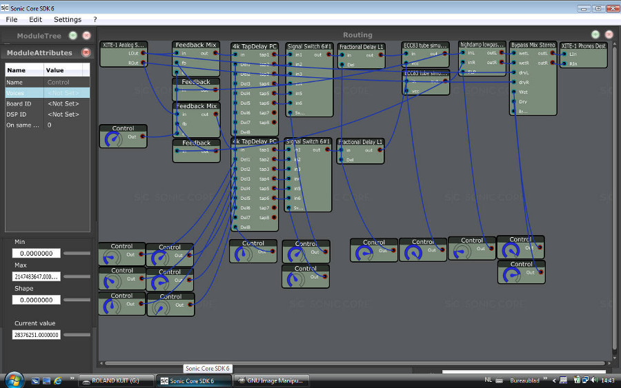

				I am totally unfamiliar with the SDK development environment, but I getting ready to jump into it with both feet. Is the following an image of a conglomeration of atoms, and is this what happens beneath the GUI? Thanks in advance!

				Re: SDK6
				Posted: Wed Mar 26, 2014 11:26 am
				by soren_jepsen
				In short: yes
The SDK6 is however, to my knowledge, still in an early alpha stage. You can get a lot more done in an earlier SDK. The GUI SDK is then for making a surface, and connect the controls to the pads of the atoms or modules. The GUI SDK however, to my knowledge, is still in an early alpha stage. I can make a gui-module with it, but it crashes the main SDK.
Cheers
Søren
