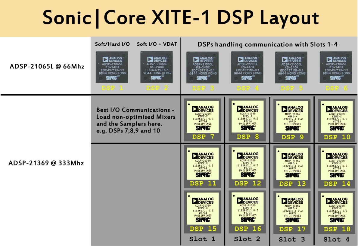

sat connections are between chips in the XITE. there are a limited number of possible connections. this is based on the architecture of the Sharcs and is not related to PCI overflow.
PCI overflow is a limitation of the PC and "no more sat connections" is a limit of the Sharcs.
which dsps are loaded can really affect the sat limit...
remember this map?
Re: DSP Overload message
Posted: Fri Sep 13, 2019 5:45 pm
garyb wrote: Fri Sep 13, 2019 3:23 pm
remember this map?
Yes, I do,- but it didn´t help always.
Posted: Fri Sep 13, 2019 8:51 pm
everything has limits.
some plugins need parts to be rebuilt for the XITE architecture. that's up to the plugin maker to figure out. many of the 3rd party plugins have XITE and PCI versions. many of the plugins that you might see limits because of sat connections are 15 years old or older.
nothing will help anything always, most limits are easily avoided, but may require choices. i know that it would be great if everything worked as one might imagine it, but on the other hand, maybe it wouldn't... :wink:
things that stretch sat connections to their limits might be best locked to a middle dsp, or something...
