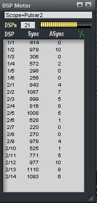

Hi, something that's been bugging me for some time, you might be able to help...
I have an old 15 DSP card and a 6 DSP, with two STDM connectors on the card edge connecting the two. I also have a syncplate, with my Presonus Digimax FS serving sample clock to Scope via Wordclock on a BNC cable...
When I start up a big project (one with lots of modules and submixers in), I usually get the DSP Load (big modules don't fit) message, which I can dismiss, and the project loads and operates fine. Is this normal? Does Scope when coming up not initially 'know' about the second card?
Also, I see in my DSP Meter window, both cards are mentioned, and all 21 DSPs are listed - board 1 has 1-6 DSPs, board 2 has 1-14. But... 6 + 14 = 20! So where's the last DSP being used? Why is it not listed in the DSP Meter? Is one DSP reserved for the Syncplate? Or other duties?
The other point is - at the top of the DSP Meter, I see 18 yellow bars, and 7 blacked-out bars (see the attached image). This I do admit is a pretty busy project! But when I switch to 96kHz sample rate on the Presonus, I get the "Big modules don't fit" message, and need to swap down to 48kHz again. Not a problem, but does upping the sample rate consume as much as 7/25's of my total 21-DSP capacity? I can increase polyphony in that same project - e.g. go from 1 to 6 polyphony on Minimax - and that fits 'fine' (a seventh voice on the Minimax does push it 'past the red' tho).
Also, the STDM Cables can come loose quite easily - I know what symptoms that presents - reach into my PC and reseat them. It's only really started to happen in the more recent past. Since this is both annoying, time consuming, and I fear I'll end up doing damage to the gold plated connectors on the card's spine, I'll use the hitfoundry.com article about making my own... Looks handy enough - have others done it?

96k DOUBLES the DSP load.
DSP overload depends on a few factors. if there is a device that takes more than one dsp, or one that must be completely on one DSP, you can see this message at much lower than full usage. the reason is that the latency between chips can make it impossible for true realtime operation. the "global optimisation" reloads the DSPs and it shuffles the order the DSPs are loaded in to try to find a combination that works better.
with some other DSP systems, there is no chance to reload in a different configuration, so when you run out of resources from a problem like this, you are done.

only 14 dsps of the 15 on a Scope card are used for devices. the 15th is for management of the system and redundancy. that's why it was removed in the later versions of the pro board.

Kinda guessed that the last DSP was for some kind of card management or redundancy. Surprising that they could dispense with it in later boards.
And my guess about the initial 'overload' message could be because it either initially doesn't register the existence of the second board on STDM, or because it attempts to assume a higher sample rate. Seems that the message comes up without actually having loaded the devices onto the cards (the dialog comes up before any of the devices are loaded into the Gui at least), so unless it attempts to pre-empt DSP usage, or if a Project has its DSP requirements in some header, ... Either way, it's no dealbreaker.
I should have noticed that 96kHz doubles the DSP count. Gonna see that for myself later this evening...

What's the best strategy to reload the devices if you max out your DSP? When presented with the Windows API dialog saying "Big Modules don't Fit", I have the opportunity to reallocate devices across the DSPs.
However, sometimes, if I add one too many devices or synth voices, I get a Scope-skinned dialog entitled PCI-Master-Overflow! "PCI capacity limit reached".
The only way I know how to get back from this is to hit Cancel on that dialog, revert the change that resulted in the overflow, and force a reload by selecting another Clock source in the Samplerate Settings window, or swapping to a different sample rate.
Also, the XTC Mode checkbox is not present in my Settings->Global window. Any idea why that might be the case? My cset.ini file looks OK, I think...
I don't miss XTC mode, but I'm curious as to why my Scope install doesn't appear to have that option available to it.
Might it be because my Project has ASIO channels? Is it Project-specific? (you wouldn't think it would be, if it's in a tab called "Global"..)

difficult to answer so many questions without missing something....
the method of reloading you mentioned is what to do if retrying a few times won't work. otherwise, try a few global optimisations(if they're available).
the lack of vstim/xtc mode might indicate that you skipped that step in the installation. if it was installed, it should be in the global settings window, no matter what.
i don't know exactly what chorus/flange fx were used in the minimax. they might just be the stock modules, but maybe not. in any case, you can use the ones in the Noah mixer, or you can use the Scope modules when you bring the audio back into Scope.
