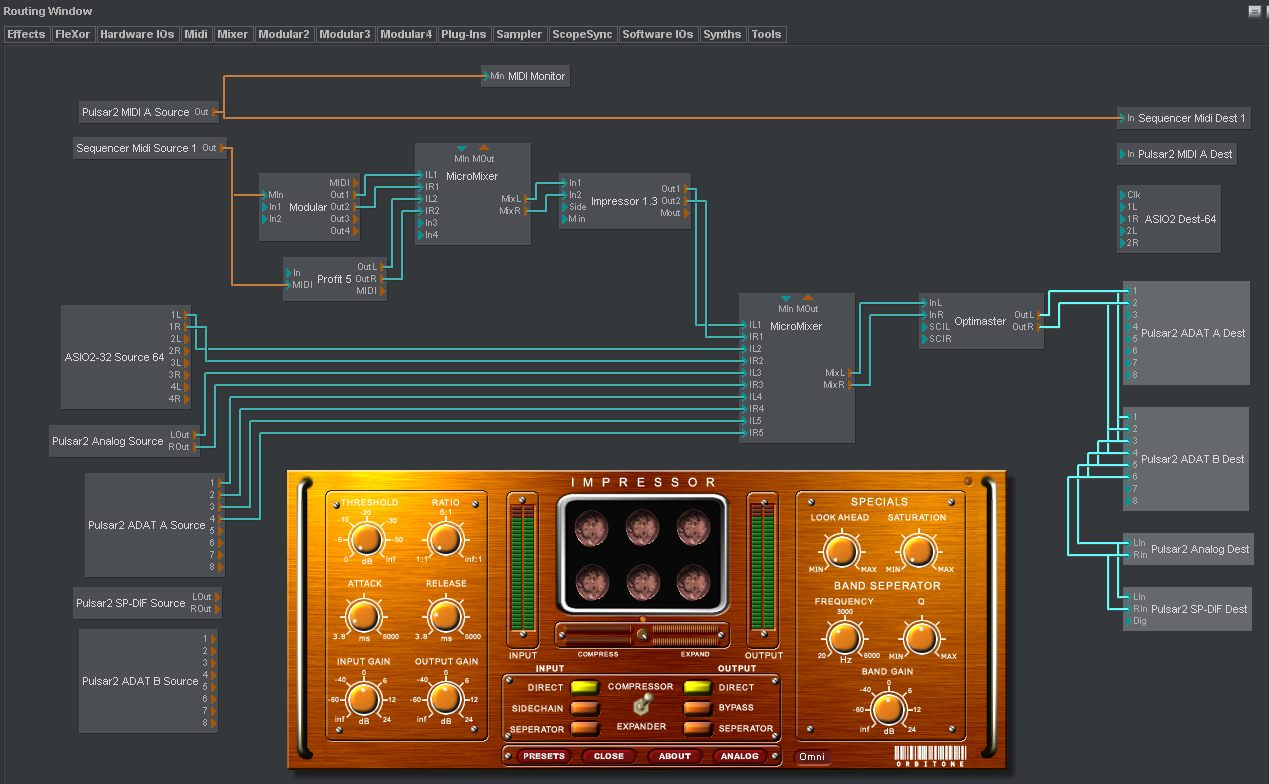

A few more tips here, about routing of signals. In the first screenshot below, note that the MIDI signals (red) can all flow from the same 'nipple' connector (on the sequencer source) to the modules I route the MIDI signals too. This seems normal. But look at the AUDIO signal path, and you'll see that in order to route the same audio signal from one module to another, you have to chain it off of the 'nipple' on the destination (where the signal connects) or INPUT of the next module, in order to do complex routing of this type:
Might save you some time figuring that out in the future. You can also see that I prefer to use Micromixers (and I enable PHASE COMP which ensures that left/right signal pairs always stay on the same DSP chip). I do this to manage my signal routing and effects very judiciously, as when projects get more complex the larger mixers eat too much DSP for me. However I use Scope in way that for me is akin to "bus" routing, or in the same way I would by chaining together multiple outboard pieces of gear and compressors when not using a mixer as the routing mechaism (ie, cabling things directly). This is just my preference but I find it works well.

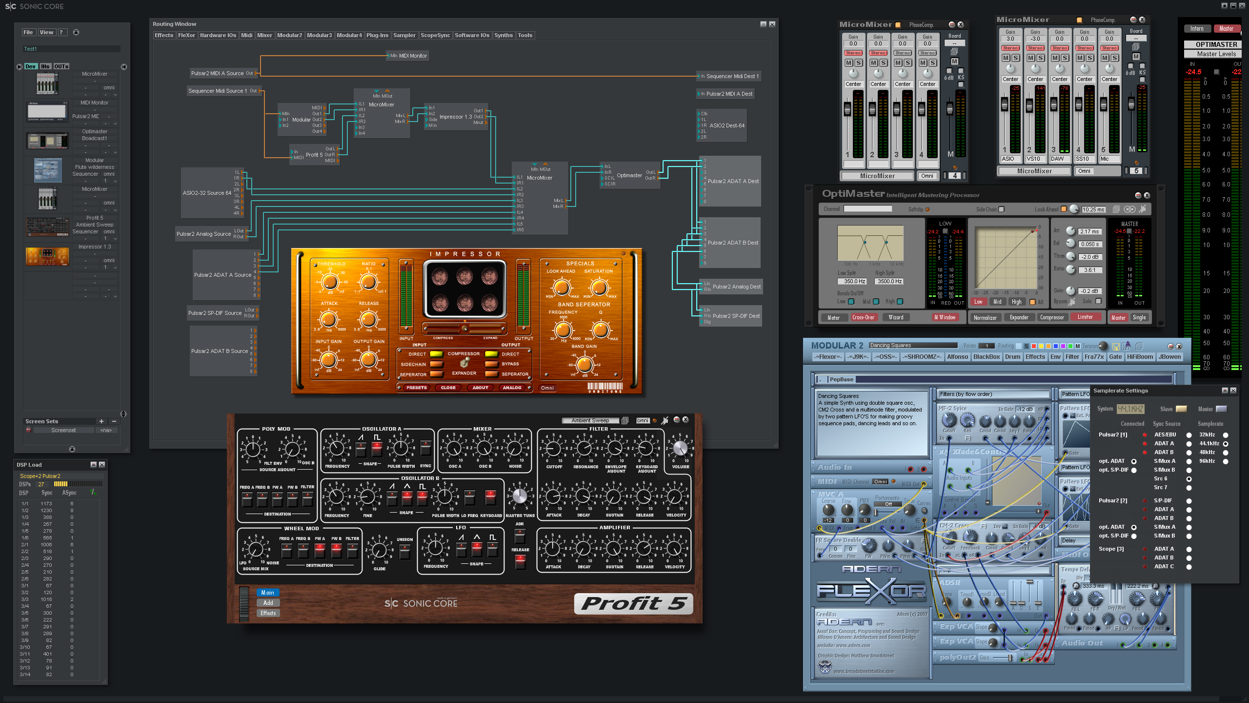

Full screenshot is here, it's just a few pads being mixed and sent over to a few different machines via ADAT so it isn't fully representative of your use case:
