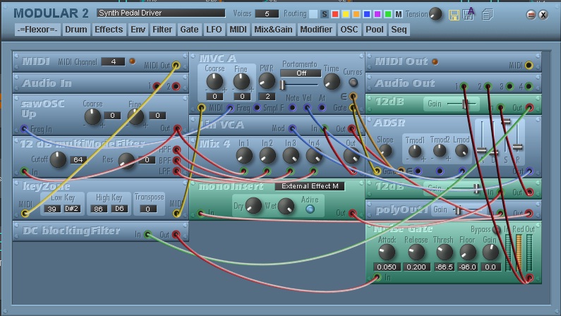

Hi dear friends, this one is not fancy at all but works great in my setup.
EHX makes some pedals thar take the guitar sound and produce some very credible polyphonic sounds of synths etc.
I needed a good Mellotron sound and hooked the EHX Mel9 to a mono I/O. Then I made this patch and I've put in the Mono Insert module an External Effect Device from the Tools. I linked it to the I/O's above and you have the mellotron pedal incorporated in the patch, you just send MIDI to it and connect it. There are options to shape a bit the sound you send for the best response.
It works flawlessly here, so I thought it might be useful. :)
