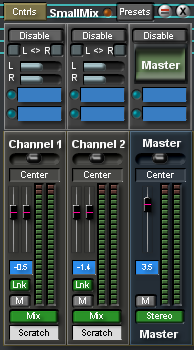

I have been working for a while now to produce mixers with minimum screen footprints,
I am in the middle of developing a number of mixers to meet this need.
Here is the most basic one that should meet your need.
Press the 'Cntrls' button to get access to extra controls and to add Fxs.
I have not done a lot of testing as yet, so if there are any issues with the mixer please let me know.
regards
maus

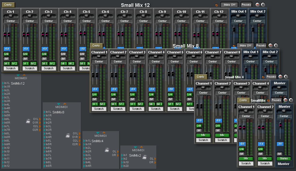

I am building a family of these mixers 2, 4, 8 ,12 and 16 stereo channel models.
Most are done, still working on the 16 channel version.
Also have not really tested them as yet.
regards
maus

Hello Maus !
The updated tiny 4 channel mixer works better,- but I still lose level compared to SpaceF Mix3S (w/ -3dB input gain) and the S|C micro mixer.
I still have to crank up the master fader more than the channel input faders,- also when these are @default levels.
The meter scaling seems to be wrong too and they should work like the meters in S|C mixers do.
P.ex. when I set the faders to 0dB or less,- there´s barely level at the stereo out and in the analyzer/level meter I use between SmallMix4 and the XITE main output.
Otherwise, everything works and the graphics issue (top of device) is gone.
Here´s the general level meter stuff from Scopev5 micro mixer manual:
I´d like to get this right, last but not least because DSP assignment/ASync on XITE is better w/ the same project and compared to SpaceF´s Mix3S.
I now hope I´m no too picky ...
And,- I´ll check the stereo switchers later.
best
