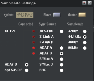

Can you post a screenshot of the Xite clock panel and samplerate settings as well?

Posted: Tue Jan 07, 2025 10:27 am
by Sextant
Capture d'écran 2025-01-07 191541.png (17.13 KiB) Viewed 30172 times
Thanks everyone for your help.
The screenshot...
I am sure that the problem does not come from an interaction between my different devices. I selectively turned everything off to test both interfaces. I tested each interface with the other off. With the Eurorack system off etc... I still have the problem
(PS. It's not a ada800, it's an Ultragain)

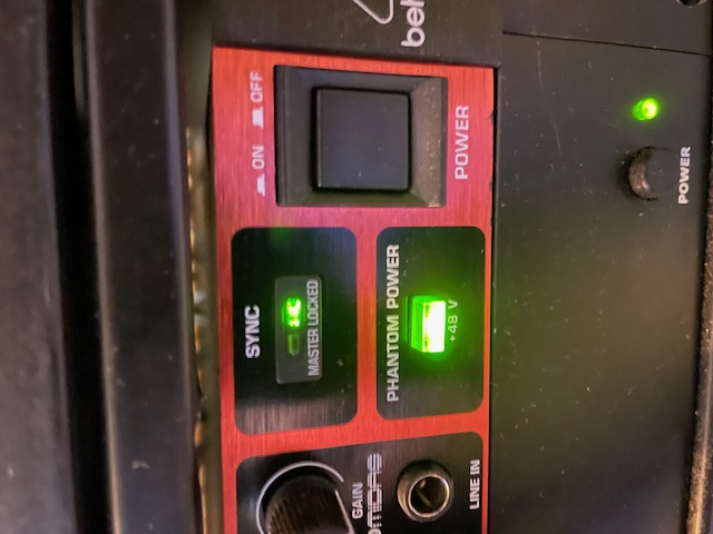

is the ADA8000 set to slave?
the ADA8000 should definitely work, if set correctly and the cables are good. did you try the other pair of ADAT ports? are you sure the cables are FULLY seated? if you are using "premium" ADAT cables, with big ends, they might not really fit the space.

UltraGain is set to slave (I guess "clocked" means slave)

Posted: Tue Jan 07, 2025 12:00 pm
by astroman
so you‘ve tested the UltraGain and the ES separately... keep it like that (for the moment).
Currently your clock master on Scope is Adat B (active black radio button).
Try with Adat A as master instead.
I have no details about changes over the years, but in (the very) early days Adat A was more reliable.
In theory my assumption is rubbish, but worth a try - it‘s a quick and simple change.
