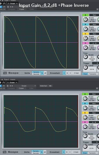

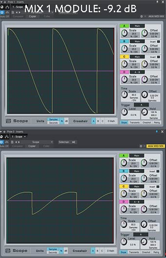

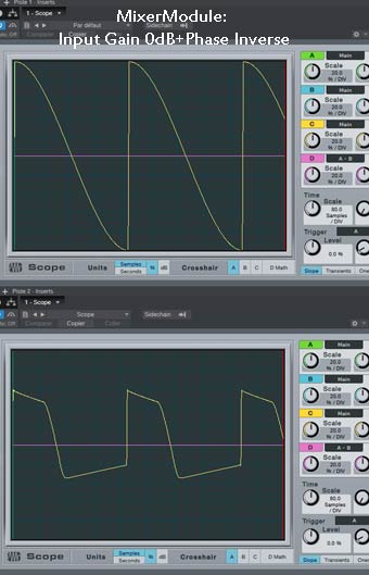

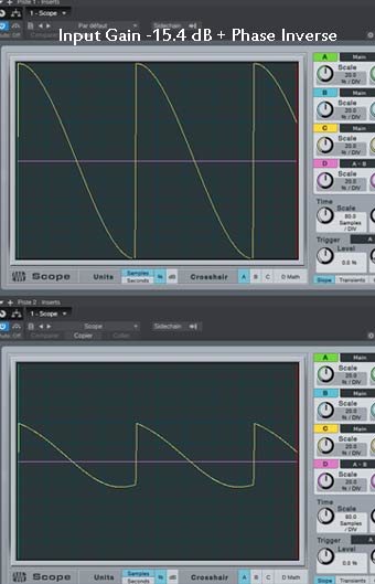

These are oscillators tests, with the mutli-oscillator of Scope on "Saw Down" (to see transients)
First image is the oscillator direct to asio, no level attenuation.
Second image is the shape when it is back to daw (though analog dests and Xite 1 xlr input+HiZ+Pad (which is very loud compared to a simple mono guitar jack = may cause additional drive). So may be I can improve something by using different jack type.
1 / my setup explained above (simple mix module, at a level that does not overdrive/clip/saturate, which depends on the sounds peak)
2/ gain @ 0dB  + phase invert using an old "Mixer Input" module from scope SDK: it is not a "mix" (level) module but a gain+phase button (so, different math than the "mix" module)

4/ gain at -15.4 dB + phase invert (best match: so if you use a gain module, the level is set differently than on a simple mix module, otherwise there is stauration/waveshaping).
Results are similar with other osc shapes.
Personal Conclusions:
By listening, the sound difference is not obvious at all (to me). it sounds more or less the same with saturation if levels are not set correctly through the whole chain (analog dest, pedal input, scope input = lots of occasion to break the wave shapes).
The shape change according to levels, and it is not the same amplitude. This could probably be solved after normalizing/gain the final recording in the daw. But pedals and external effect will play with less dynamics/amplitude.
I do not have a reamp box to compare, but I would conclude that if you use the workaround method (no reamp box ), the result will depend on the modules used before the analog dest, and that it could be better to invert phase in the daw, on the final recording.

I think I found a way to make new oscillator shapes with scope modules, this can be used with Blackbox III macro osc and filter, sending the osc out of scope, driving it, and then getting the sound back and send it to a filter .. may be not advised ... I don't know. for experimenters only.
