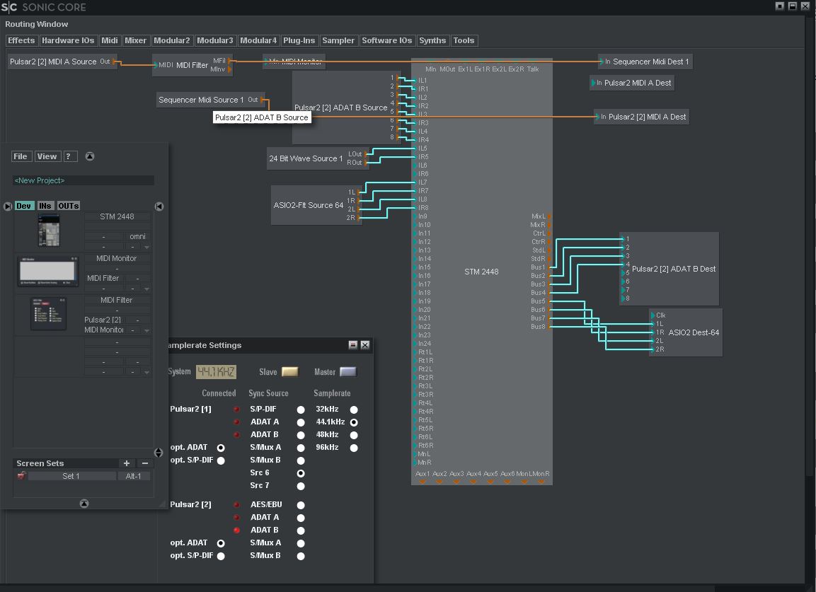

				3 Scope Project cards (1 is a booster)  Windows 10 64bit  Scope PCI v7
My DAWs are not showing any Scope MIDI ports.  (Reaper/Ableton)
1.  Sequencer MIDI In/Out modules are loaded in the project window before start.

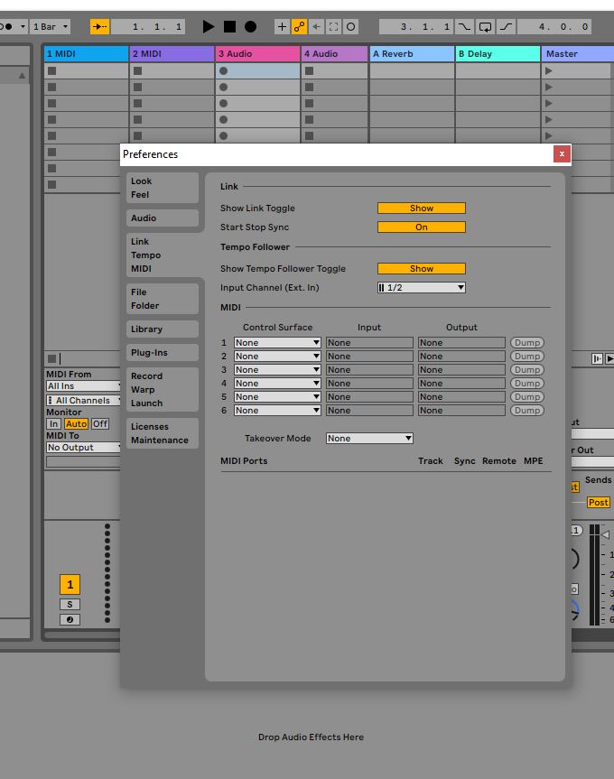

Surely you know how to enable midi within Ableton, can you post a screenshot of the midi/controller page just in case?
Not true from my experience.  I have Ableton running on Win 11 with my Xite and it has been working great.
I would be inclined to pursue that the DAW might be the issue except to me it is not likely since I am getting the same behavior with 2 seperate DAWS.
I'm probably looking at a complete uninstall for Scope with probably a registry hack to erase all data?
- Project Window.JPG (96.75 KiB) Viewed 8375 times
- Ableton.JPG (76.49 KiB) Viewed 8375 times

				So this was a MIDI problem only in the DAW.  Scope ASIO has been working fine in Ableton 11 on Win 10/11 without compatibility mode.
The issue was both Ableton and Reaper and other Daw's were not  recoginizing Scope MIDI and USB MIDI.
I have since resolved the issue by doing a Windows System Reset.
