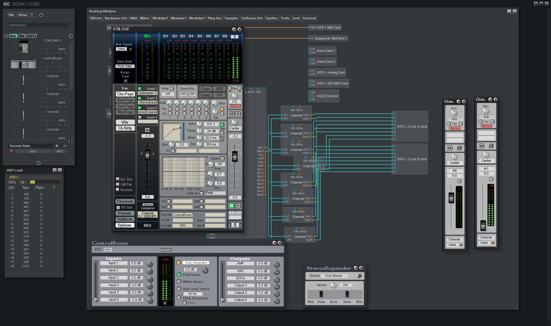

So here comes the "howto repeat":
Using noise from controlroom goes through mixer, is then spread to a bunch of channel-elements.
Channel element connected to Z-link1-78 is connected to speakers.
Everythink works.
Now I assign the (shifted) channel-element to dsp7, the sound disappears.
Now I assign the (shifted) channel-element to dsp8, the sound comes back.
Now I assign the (shifted) channel-element to dsp7 again, the sound stays.
I save the project.
I load the saved project and no sound audible. The meter of the allocated channel shows no input signal. (see attached picture) No DSP-assignment is visible in the dsp-menu.
I can get the sound back by allocating to some dsp.. (tried 6, 7.. worked)
I attached the projects before and after assignment to dsp7..
999_tests.zip
(661.95 KiB) Downloaded 390 times

nebelfuerst; Thanks for the screenshot and project files.
So after testing both project files I did not have any issues with the sound. Placed all devices on DSP 7 (except the STM mixer) and it still worked fine. Moved a bunch of other devices in the project to different DSPs and did not lose any sound.
Not sure if you know this but the STM2448X, STM 48 S X, and STM 4896 X appear to be locked to DSP10.
I would recommend you build your project from scratch and test it again for the same performance.

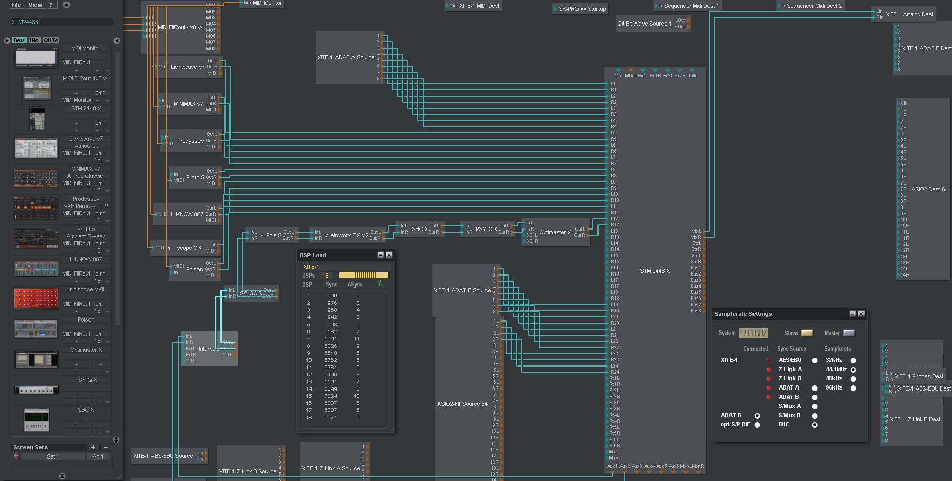

Not all the users own and use the sdk and I also have the impression DSP systems behave different in (PCI) and being connected (XITE) to different computers.
B.t.w.,- I wasn´t able rebuilding Yayajohn´s XITE-1 project where he maxed out polyphony up to 16 voices for every SCOPE stock synth.
In fact, I gave up after some time and accepted it doesn´t work w/ my XITE-1 which is using the older PCIe card (w/ DVI connector) in my 19" 4U rackmount DAW PC (Z97, Intel i7 4790K, 32BG RAM, SSDs, Win7 Pro SP1, SCOPE v7 x64).
With my system, I get SAT connection error messages soon and when I load about 4 or 5 synths and try to max out polyphony to 16 voices for each.
I made a PDF from his post and put it in the attachment,- just as a reminder what we´re talkin´ about.
Below a pic of his project.
XITE-1 Test Project - Yayajohn..pdf
(1 MiB) Downloaded 447 times
