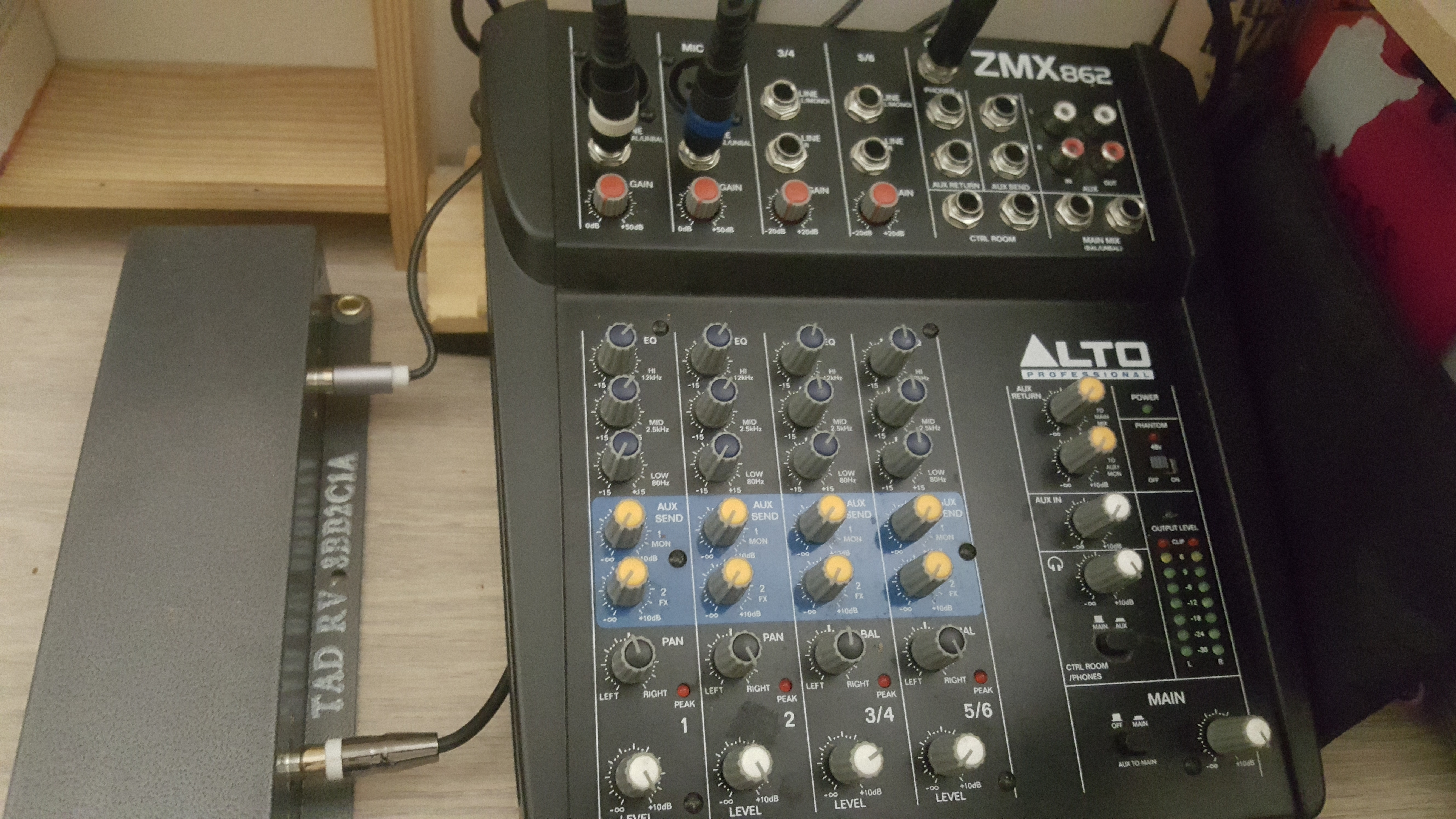

Ok, at last, 1 year later, here is my rig for a Spring reverb on line outputs.
One can use headphone output of Xite to send directly to a spring reverb,
Here are two YT tutorials about that:
https://www.youtube.com/watch?v=CXJdSREWxxY
https://www.youtube.com/watch?v=vIryyi3bp-c&t=1s
but I need the headphones out, to use headphones, so I needed to use Line I/Os to save the headphones out.
Problem: headphone amplifiers are not made to be plugged on Line outs (they just extend the headphones output). So it is useless if one needs to use Line i/os (except more expensive models probably).
- I got a second hand mixtable (alto ZMX862) with most outputs @ 120 ohms, including headphone output. So it is like a headphone amplifier with extra functions. I can feed it with line level signals (you can't do that with headphone amplifiers).
- The Spring is BB type ( 150/190 Ohms input /// 2575 ohm output)
- The Spring goes to a HiZ input of Xite with RCA to TS cable.
cost: 40 € second hand mixtable + 30 € spring (NEW) + 18.50 DHL + 9.99 2*RCA to TS" cables = 98,49 €
You could add another tank and use PAN to route signals to one or the other or both, in dual mono or stereo.
that would be around 150 € for a dual spring setup.
One could add a DI box to convert the HiZ from the Spring into a Line signal (a dual box for stereo).
Voilà, problem solved, sounds better than IRs
Will allow to turn many Scope Delays into proper "EchoVerb" units.
Made me think that of SOnic Core ever does another card, it would be incredible to have spring i/os to use them directly
. (lol, that would be unique)

- spacef-spring-ring.jpg (4.82 MiB) Viewed 38329 times

Re: will this spring reverb work as an aux (impedance/RCA)
Here are some pics of my final setup. I also made devices for them fo Scope/Xite, that you can find
here viewtopic.php?p=356852#p356852
or there https://spacef-devices.com/free-downloads/
They are Send/Returns tailored for mono effects. Fully tested with the pictured setup
Sounds really great like that...
