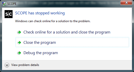

Havent really had the need to do this for many years however I've tried to load some FX into the routing window but Scope crashes. I re-installed Scope but the same thing happens on the default project. When it crashes I can just restart Scope so it's not like I have to restart the computer.
I decided to work through all the plug-ins, testing which ones crashed scope and those that didnt. I've attached the results in a txt file.
The behaviour is the same regardless of whether a plug-in is mono or stereo with the exception of GraphEQ - the stereo version works but the mono one crashes. When it crashes, it loads the plug-in module into the routing window then immediately pops up with a message to say Scope has stopped working:
Scope stopped working error.png (30.21 KiB) Viewed 2146 times

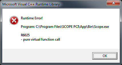

There are 3 other plug-ins that also generate a runtime error before the Scope has stopped working error message - stereo versions of SSB Modulator, SC-Autogate and Multitap delay:
Scope runtime error.png (19.33 KiB) Viewed 2146 times
Loading any of these plug-ins into a mixer or multi-fx plugin works ok however I'd like to resolve the crashing issue in case I or a friend forget not to do this and crash Scope and lose work. Has anyone else experienced this and know how to fix it?

Hmm that is strange. Forgot to add I’m on 64bit and using 2 Scope Pro PCI cards-original post amended accordingly.
I’m loading the plug-ins via the drop down menu.
I discovered the issue when I tried to load a stereo gate effect and after I did the re-install of Scope it worked and I could load it into the routing window but then stopped working again. I did initially think that my previous project was corrupt because when I loaded that into the new install the errors re-occurred so I started rebuilding my project from scratch but about halfway through I thought I would test loading a gate effect and the errors started again.
I renamed the previous Scope install directory before re-installing but checked the new install and the plug-in file paths are pointing to the new install and not the old install.
It’s very strange!

Scope Setting -> Global -> Show Desktop. Enabling this STOPPED the R6025 'pure virtual function call' error I was getting on loading the SC-AutoGate and the SC-Brickwall EQ. These plugins now load normally. Switch to 'Hide Desktop' option and the crashes occur again. This is Scope XITE x64 and Scope PCI x64 both Win8 and Win10 fresh installs.
Posts: 7750
Re: Scope Crashes When Loading FX into Routing Window
^^ send to support please for current beta. Note I only use show desktop mode for so long I can’t remember why, but There were other issues as well if I recall.
