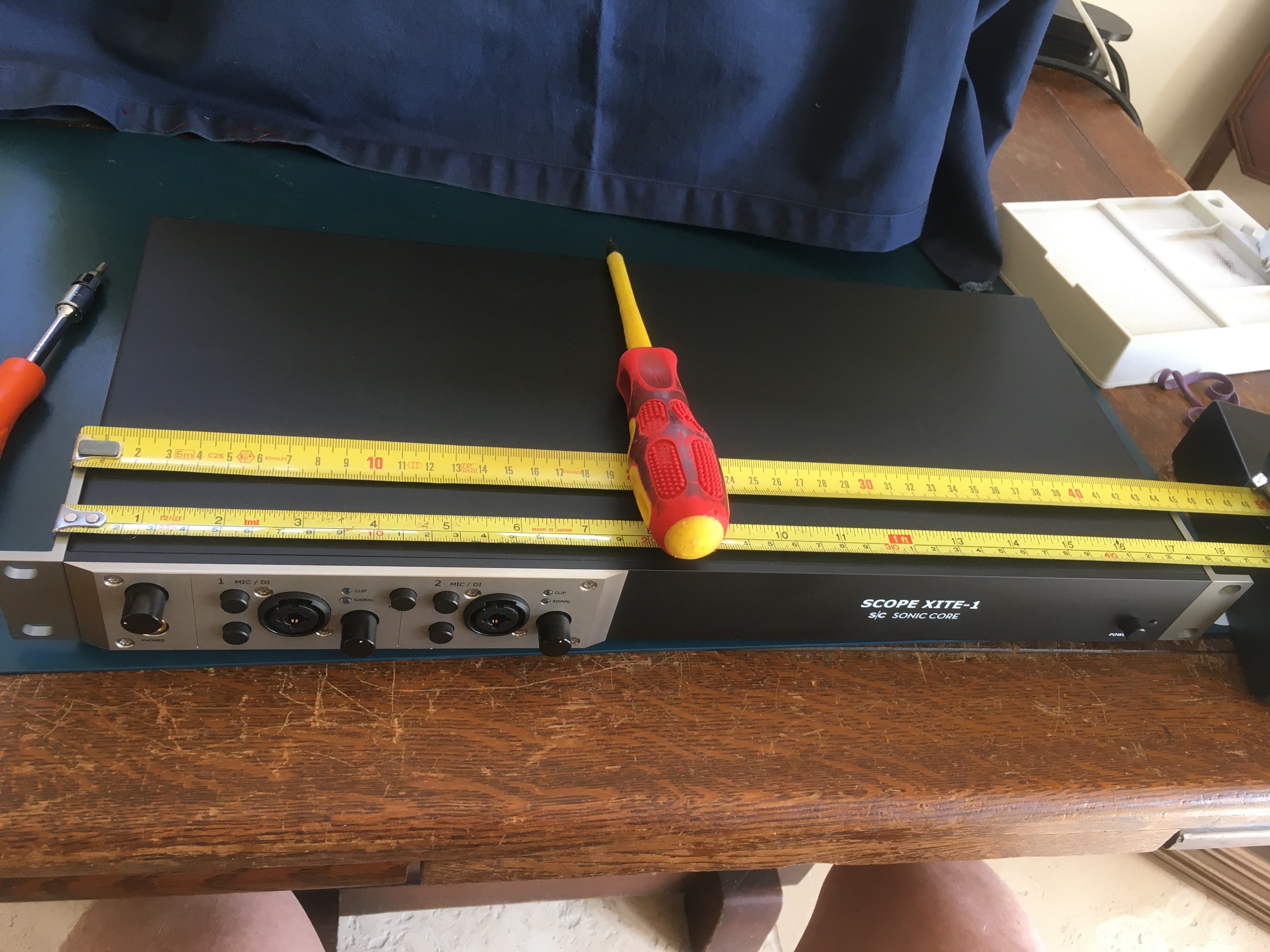

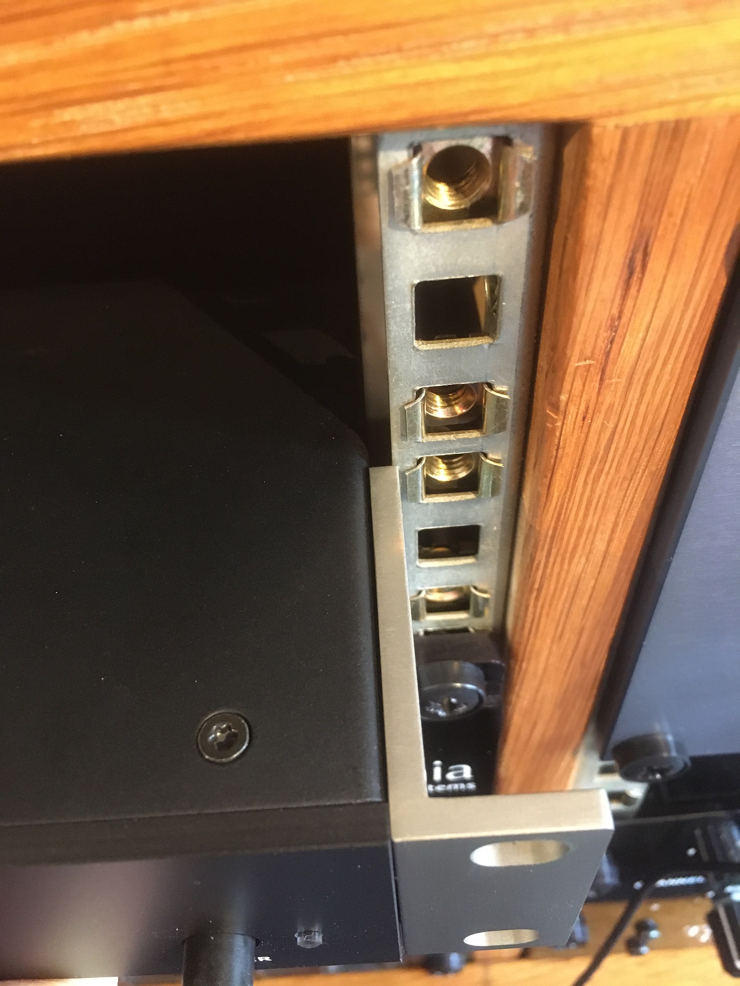

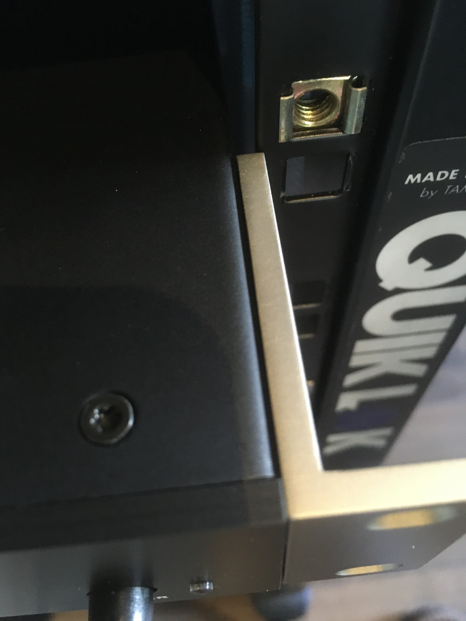

Does anyone here have their XITE-1 racked? I have always had my XITE sitting on top of my Quiklok rack stand so it never needed rack ears. But having recently moved I am setting up the studio again and wanted to put the XITE in a rack space in my (ex BBC) desk I just bought since my Quiklok rack stand is now further away. I couldn't find my original rack ears as I must have removed them from the XITE years ago, so I purchased a new pair of ears from SC. However with the rack ears now attached the XITE will not fit in any of the desk's 4 rack spaces. To make sure it wasn't the desk spaces that were the issue I then tried fitting the XITE into my Quiklok rack stand but had the same problem, it just won't fit with the rack ears and is too wide by about 1-2mm.
I emailed SC but I guess there is not much they can do other than take note for future design. But it seems strange that the rack ears make the XITE the only piece of gear I have that doesn't fit the desk rack or the Quiklok rack, out of almost 30 other rackable pieces of gear, every single other piece fits both racks. Using calipers I measured the thickness of the rack ear alloy and it is approx 3.78mm, so a pair adds 7.56mm to the width of the XITE for racking purposes, whereas without the ears the XITE fits in a rack space with plenty of room to spare on each side.
So I just wanted to find out how many others here have their XITE racked, or do you have it free standing.
Xite-1 won't fit in desk rack.jpg (828.08 KiB) Viewed 25229 times
Xite-1 won't fit in Quiklok rack.jpg (767.59 KiB) Viewed 25229 times

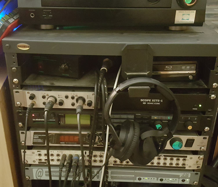

Re: XITE-1 won't fit rack as rack ears are too thick
Posted: Thu Jun 30, 2022 1:35 pm
by spacef
I have it in a Samson rack and there is no issue.
The only difference I see with your pics, is that - on y model - the black ear is near the power button (on the right), and the golden ear is on the left, near the headphone plug.
Could your rack-ear be reversed ? would it change something if you mount them the other way around ?
pic of my own rack to check ear colors... I hope it helps (even though I am not sure that the color scheme is on all xite... at least, try reversing them.
