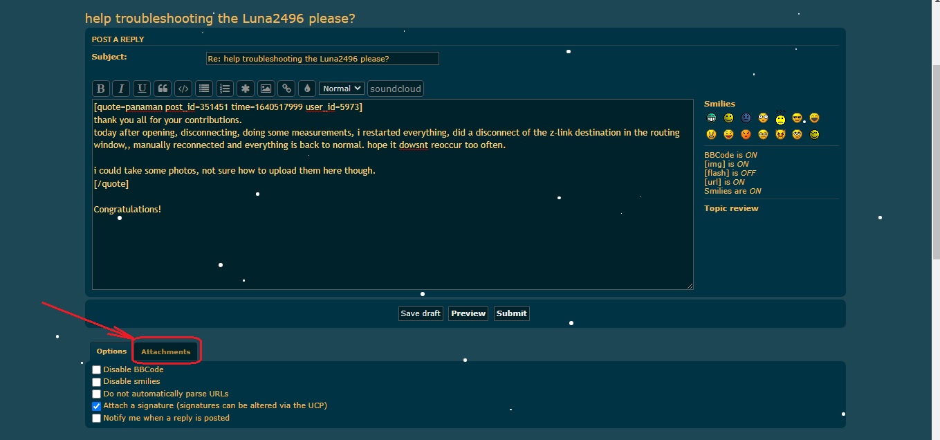

Use "Attachments" tab for the pics. But only ONE picture per post allowed.
Or better (faster) - zip all your photos into one file and use
https://turbobit.net   to upload it for share...
