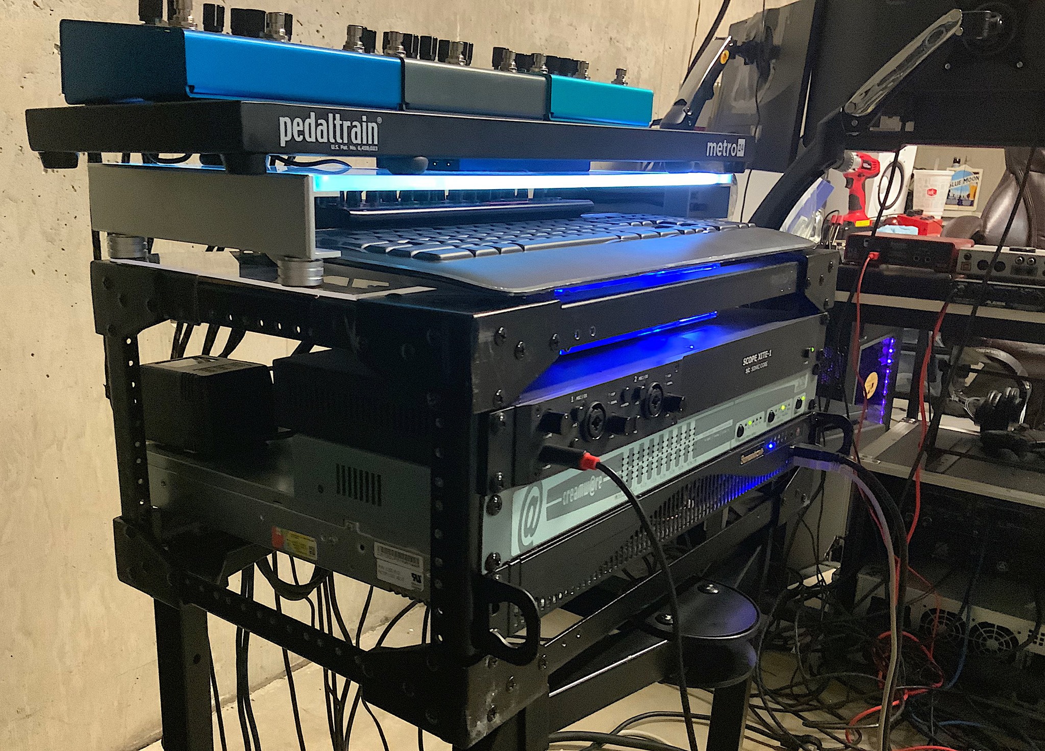

No nostalgia here just functional value 8)
Did you also know that Scope can use both ADAT and Z-Link at the same time? I am currently using all of the I/O's on my Xite-1.
Most people do not covet their A16U's for the ADAT just so you know.
If you aren't going to use the Z-link on your Scope cards then I would suggest offering them for trade or at least trade the plates. There are always people looking for Z-link plates. (and sync plates even more)
