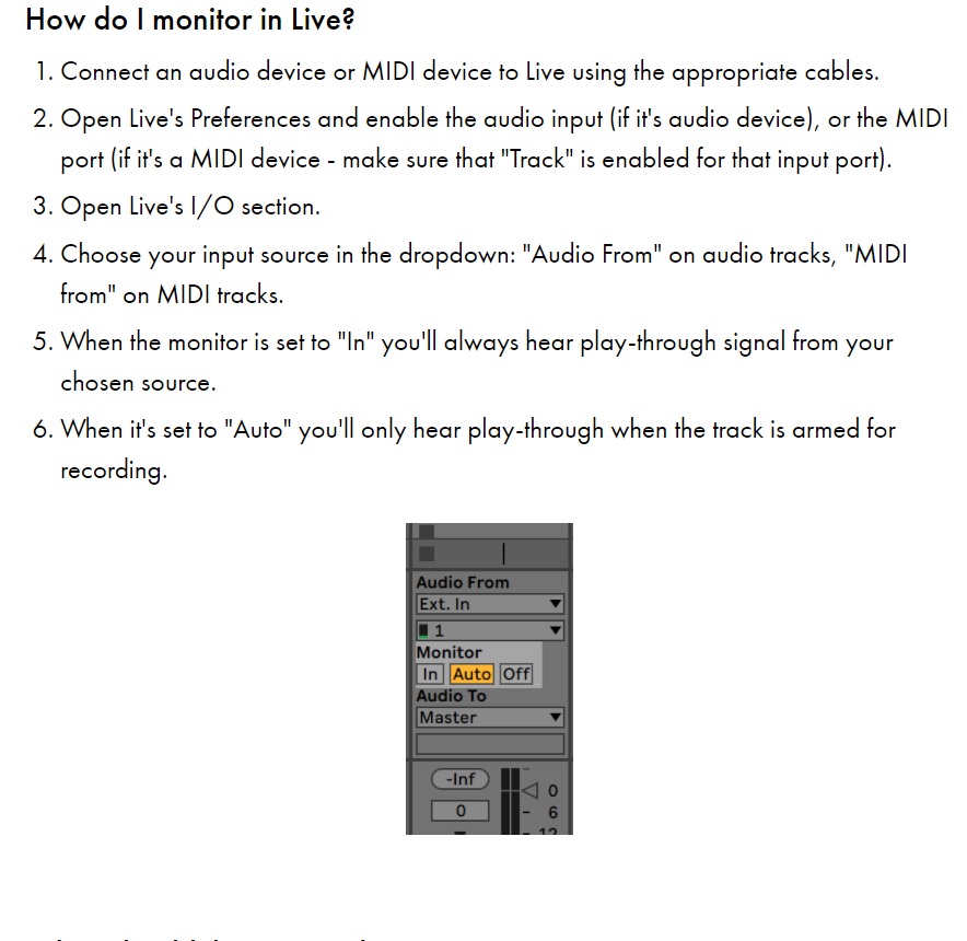

The DAWs are just a better vdat to me, as I try to keep all effects in scope. All equipment is synchronised by midiclock.
As I use the mini-mixer to hand over to my DAW and the DAW summary is feed in to the scope mixer, I somewhat feel that this is not the idea solution. I have to manually mute the DAW-input, as I otherwise end up in feedback loops.

there should be a setting to disable software input monitoring. Cubase, Samplitude, Reason and Cakewalk have had this for years and years. i'm sure Ableton and Bitwig do as well.

good thinking - :
https://help.ableton.com/hc/en-us/artic ... ng-in-Live
ableton-live-monitoring

Set to 'off' if you monitor directly via Scope while recording.
"Auto" for software monitoring rather than Scope.
'In' is basically 'on' (to process external signals always).

I will try to rethink my scope&DAW workflow. Maybe it's as simple as disabling input monitoring.

If not using software monitoring, note the part that says Why are my recordings out of sync?
