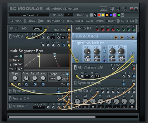

				Here is the result of the days labors.  Much thanks to Spielraum for helping me get started.
I have this set to control the AUx send 1 dial in the STM2448 mixer.  NN22 triggers it to open very slowly and stays open with an ENV loop to basically infinity haha.  Then NN22 will close it per the decay set in the AD Vintage.  Any other note will close it immediately.
https://youtu.be/Ce5L5UjT9iI
- MIDINotetoCCEnvelope.jpg (87.12 KiB) Viewed 30802 times
Instructions:
-Set your note on and off numbers in the gateSwitcher
-Set your CC output with the R8 CtrlA dial
-Adjust your Envelopes as desired.
Prob not going to ever get it to sync per bar but this will do for now.
Hope it works for you.  Haven't been in modular in a while so I probably screwed something up or did something that will make you scratch your head so comments and suggestions are welcome.
 it was a fun day.
Cheers
Dan
