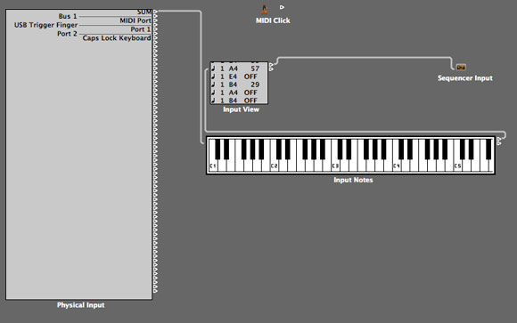

				That will work indeed.  However you can directly wire the input and output in the 'clicks and ports' layer of the environment:
- default.jpg (20.47 KiB) Viewed 1762 times
Just wire either the SUM or the input port in question (better) directly to that multi instrument.
Tip, you can hold a modifier key when clicking there and get a dropdown menu of all items in the environment that will accept input so you can 'wire' between layers.  Make sure you remove the multi that you're using for input if you do this...
